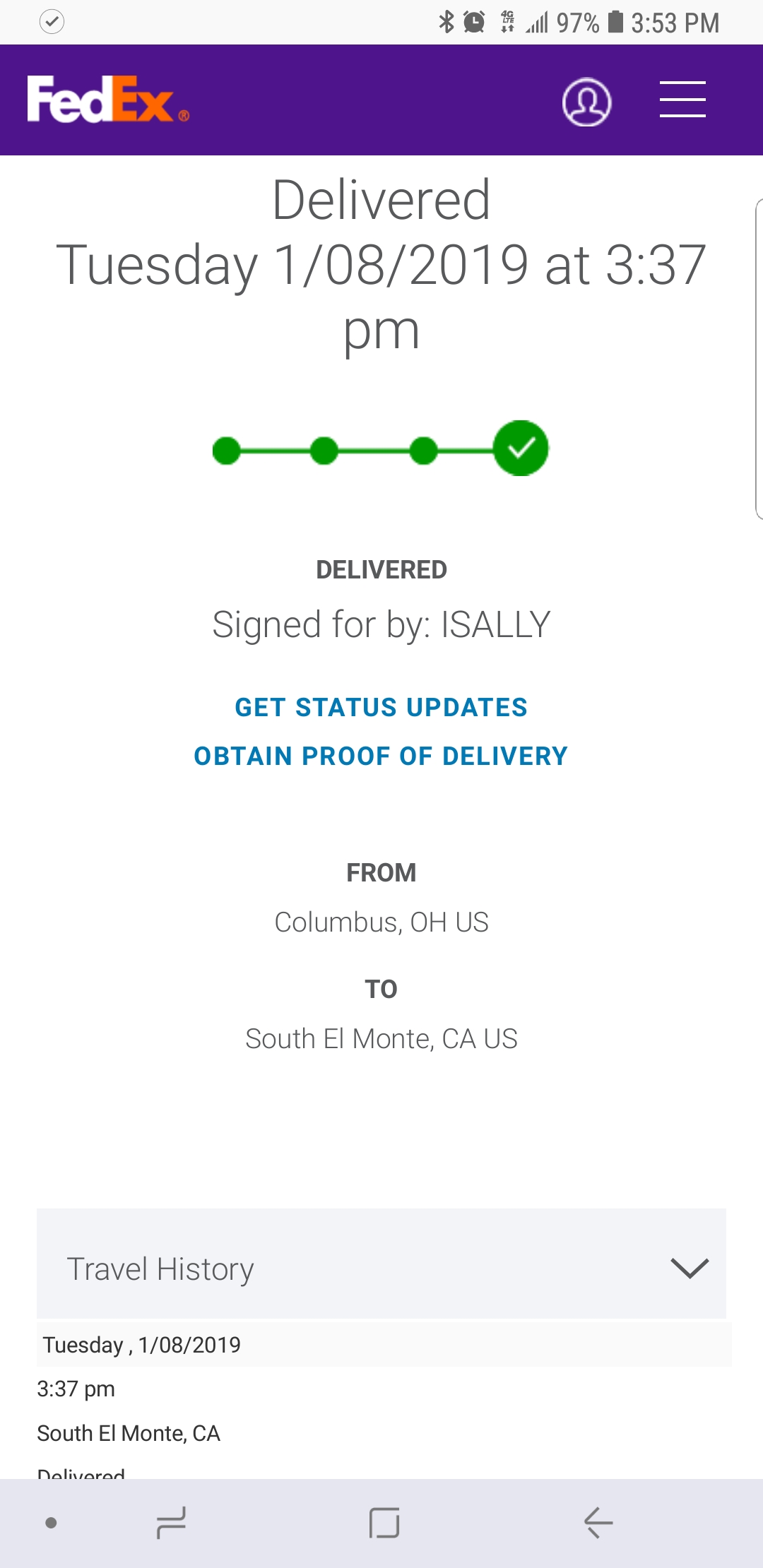

Post by zinofan » Wed Jan 09, 2019 3:56 pm
Hi Ailsa, the zino was delievered yesterday. Can you please ship the new Zino?
Re: Gimbal protection error - Zino 0x0004 - Warranty Service - Shipped back to Hubsan
Post by Hubsan-Ailsa » Thu Jan 10, 2019 5:50 am
Hello zinofan ,
I am checking this tracking details with our colleague in the Hubsan USA office.Once the Zino arrived ,we will send you a new one.Thanks
