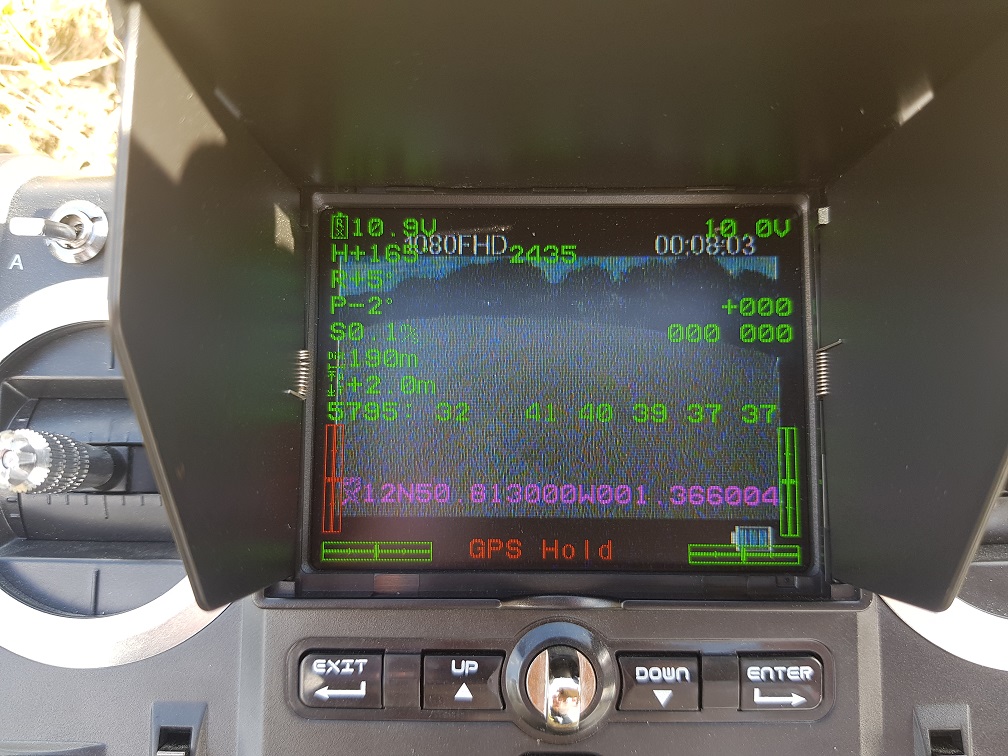

Thanks for the info. My controller is the standard one and has the 2 ports on the bottom of it. Here is a photo of the handset at 190m range where it lost control today
190m away.jpg (298.48 KiB) Viewed 40972 times
I am losing flight control, at this point the FPV is still working just, it is starting to break up. Telemetry on the handset is still updating.

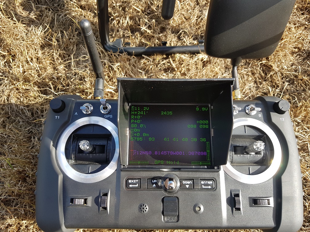

Here are the figures for 31m away
31m away.jpg (293.55 KiB) Viewed 40972 times
and one for handset next to the drone
handset next to drone after flying.jpg (472.74 KiB) Viewed 40972 times
