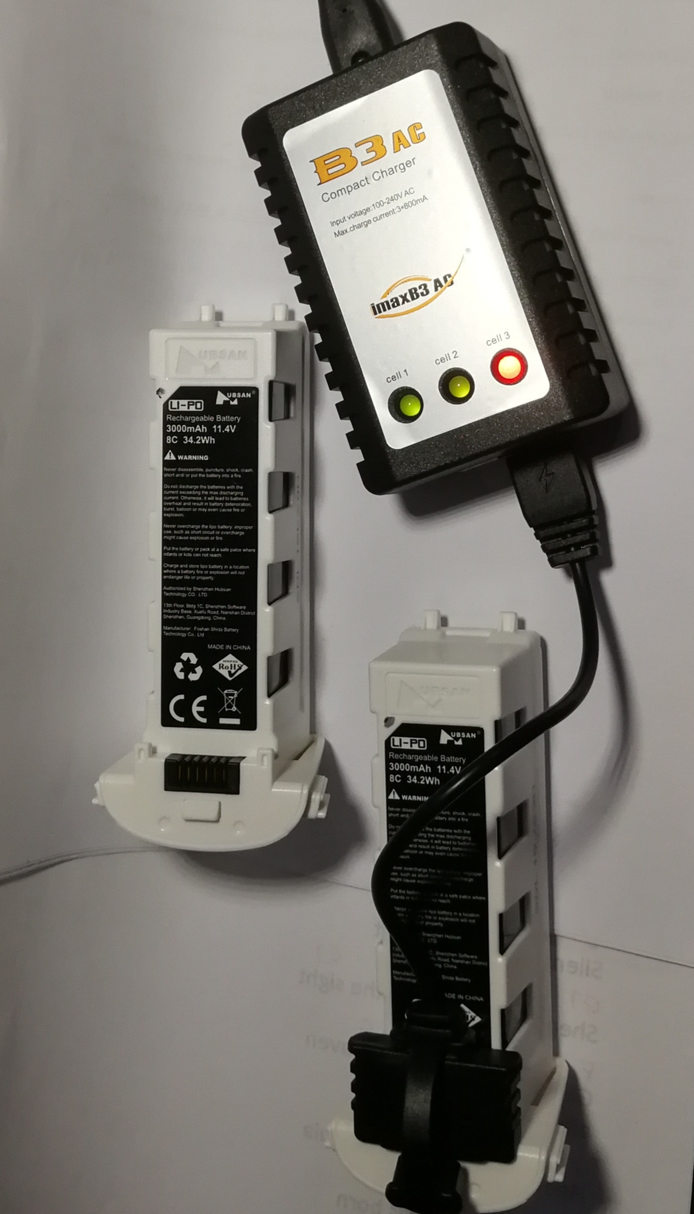

I bought this 2S/3S balance charger as a spare to the supplied charger(which looks like a toy charger
). Two cells already charged - one still charging. I hope it is more suitable.

- IMG_20181222_180847.jpg (672.3 KiB) Viewed 8776 times

Re: photo above - cell 3 took an extra 45mins to charge before the green light came on to indicate fully charged. Can anyone interpret this?
