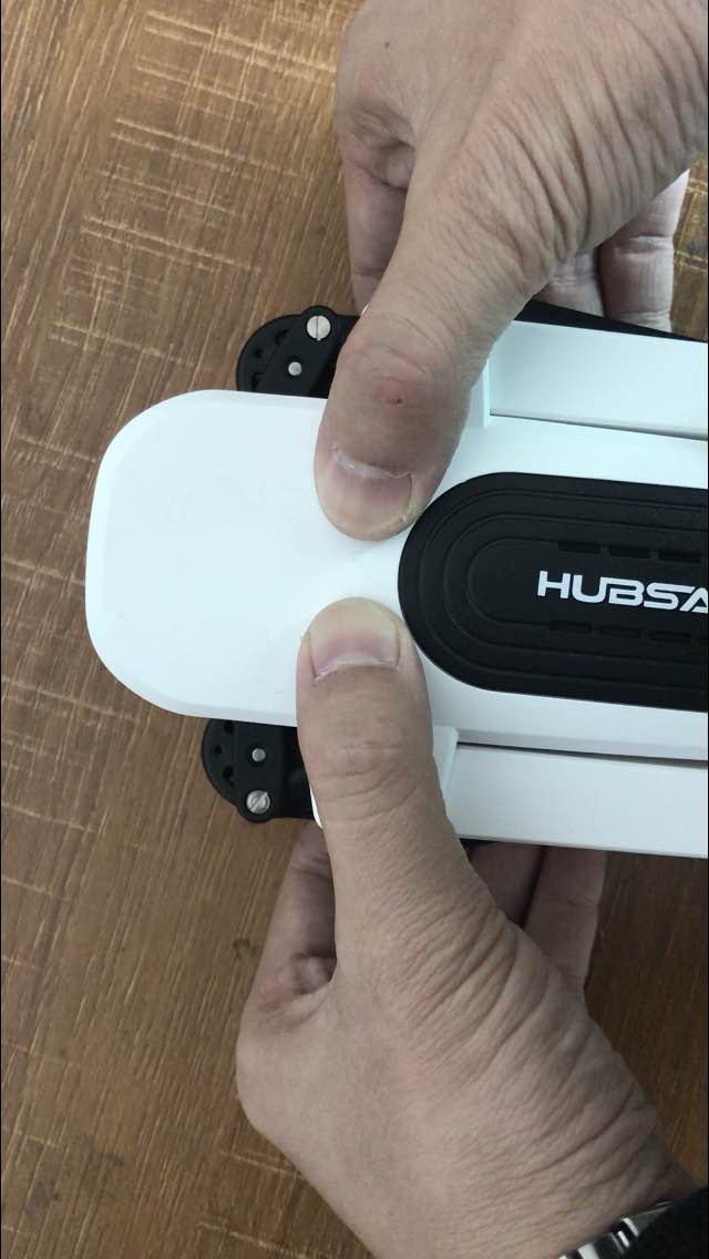

- Posts: 1027
Re: Can't update the camera Firmware (With Video)
Hello me_24733Rj73H,
We noticed that there have red light flash in the drone either you put the SD card or not.would you mind to press the Zino nose as attached picture then to update?Hope it will help you.

- Posts: 49
- Joined: Sat Nov 17, 2018 1:40 pm
- Location: Italy
Thanks again for the help, i have try ti Press the nose, before and After Power on the aircraft, but nothing happen... I try an u3 SD card and i tell you ...
