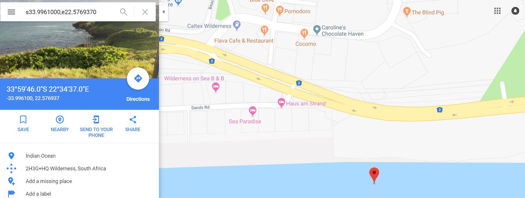

I took off from the spot where the rest of my family was sitting. Everything was good when taking off. After flying out the distance above i hit return to home, i saw the drone turn around facing my direction on the video and at that same moment all signal dropped and it said not connected. I walked away about 50m to see if i can gain signal, nothing.

After updating drone firmware drone lost connection from controller while retuning home. it's looks like the drone completely shut down in mid air as the picture shows the last position of drone. Unable to retrieve drone. Fault in update? Please advise why it would shut down in mid air. As I'm on holiday and very disappointed of this occurrence.
As i can see on the photo distance is 977 meters which at range limit. Signal lost is a normal issue on this point. İf there is enough battery it should have returned to home.

I am sorry you lost your Zino but it looks like from your controller coordinates the RTH position was the Indian Ocean. Poor location accuracy at take off :?:
