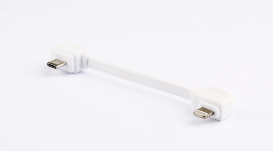

So I think I just found the issue ,It appears that it is the adapter cable (Lightning connector) for iphone)
I pulled my phone out of the case and tried and still no luck but when I push the cable into my phone and and keep pressure on it I got it to work.
I have no issues with any of my other iphone lightning cables and sync my phone with itunes on my computer pretty much every night so I beliee this adapter cable to be faulty.
unfortunately while wiggling the cable and such a bit ago and turning on the motors to idle I must have touched something on my phone or otherwise wiggled the cable when I shouldnt have while moors were at idle and I had a fly away in my kitchen destroying almost all of my propellers
So now I need a replacement iphone cable and also another set of propellers

- Posts: 1027
Re: Faulty Transmitter wont pair!
Hello BrettYoung,
You mean there have something wrong with your Iphone cable as attached below.right?
I email you for this issue.
Hubsan-Ailsa wrote: ↑Fri Dec 14, 2018 6:56 amHello BrettYoung,
Correct!
