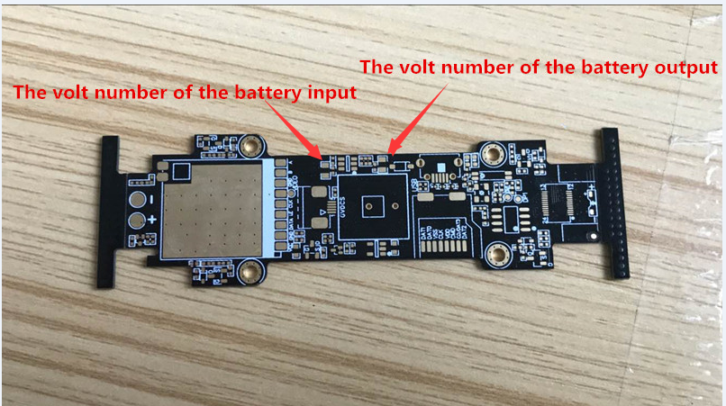

Re: Hubsan H122D not powering up
Post by Hubsan-Ailsa » Thu Jun 14, 2018 7:28 am
Hi Kindly test the volt number of the place where I quoted in red color. Especially note that if there have 5 volt in where battery output.
5v output volt.png (505.74 KiB) Viewed 10631 times
kay
Posts: 10
Joined: Tue Jun 12, 2018 6:00 pm
Post by kay » Thu Jun 14, 2018 6:32 pm
At the battery outlet, there is 1.57 volts, when connect ohmmeter between outlet and inlet, it reads 6.93 volt, battery alone is 8.43 volts.
