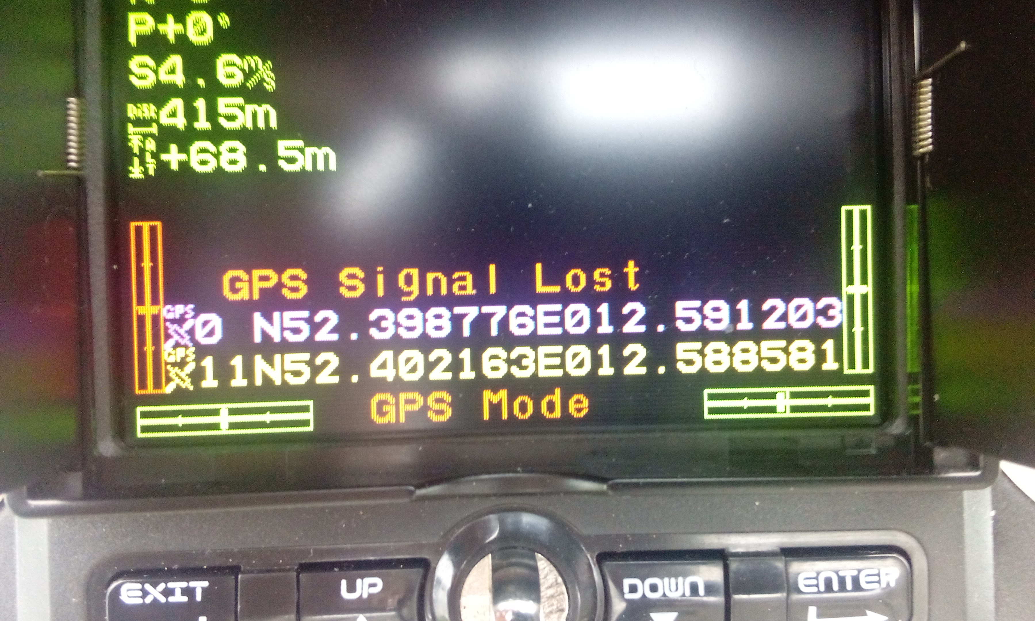

Hello Ailsa, today can answer now:
I flew about at wind force 2 - 3 Bft on a meadow. The sky was slightly cloudy.
The copter had initially found 10 satellites. I could start and fly.
Then suddenly, it drifts off and becomes uncontrollable and flies away.
A photo of the coordinates I have attached.
Good looking if there would be at Hubsan for the loss a good price for the Copter 501a individually also without accessories to reorder.
Best regards Juergen

- Posts: 1027
Re: hubsan 501a
Hello Bellinus,
I saw there is 0 GPS satellites for the drone showed on the LCD.which might be a reason for the drone lost.
Did you fly the drone in a open flat place?
Re: hubsan 501a
Hello Alisa,
The reason is most likely that Hubsan has a problem with maintaining the GPS signal on the copter.
When the sky was slightly cloudy, I had 11 satellites on the transmitter and when the copter suddenly flew away I had 0 satelites on the transmitter screen for the Copter.
It will be impossible to find it back!
So Hubsan - check and rework!
Regards Juergen
