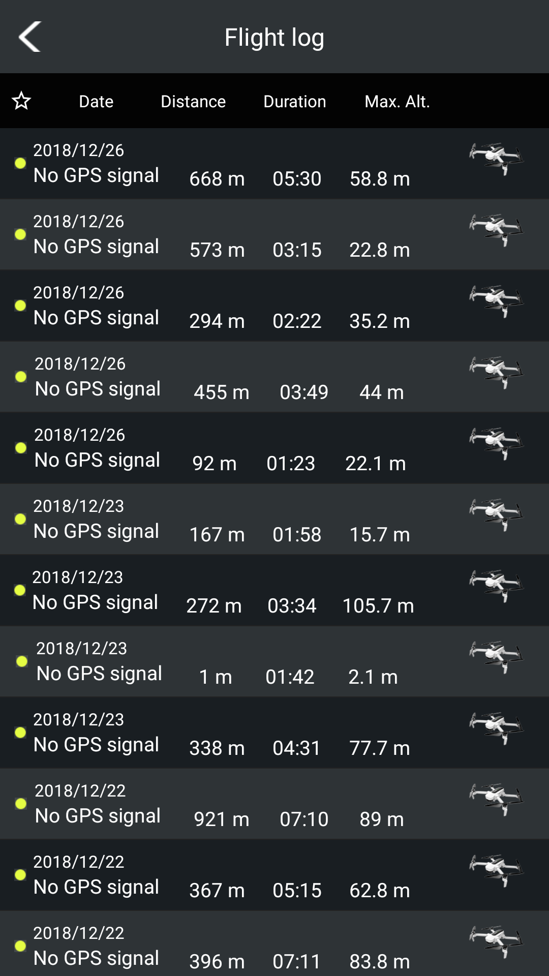

All updates done but running FC version FC-V1.0.43. Android Samsung Note 4. Compass calibrated on every flight. Camera works fantastic. Battery life close to 18 mins at 25% charge remaining in windy conditions.
I have had a relatively good experience with my Zino so far. I would like to point out the issues I've had so far and invite comments.
1. The GPS accuracy test always fails and as a result, I cannot do the automated modes like follow me, orbit, line follow etc.
2. I loose connection with the Zino some times for a short time (~10 seconds) flying within LOS and in an open park and then the zino does some weird stuff flying high speed in a random direction and not responding to stick commands..very scary. This has happened at least once in every flight. I fly in low interference areas.
3. I have attached my flight log and it says "No GPS Signal". Perhaps someone can enlighten me to what this means - Is this reporting a temporary loss of GPS signal?. RTH and altitude hold works normally.
4. Yaw and gimbal movement is not smooth. You need this for video work.
5. Change log in updates is not comprehensive for every version and needs to be updated every time there is a new update.
I realize this is a work in progress and wait for solutions from users and Hubsan patiently.
Zino Flight Log.png (385.54 KiB) Viewed 7942 times

I may be wrong,but I think that means your phone. Do u have"location"turned on?

Post by ge_8efac33d06 » Wed Dec 26, 2018 6:45 pm
Yes, location is turned on. I did notice that when conducting the GPS accuracy test, its constantly showing 0 meters on the screen as the difference between aircraft and phone locations and is not changing. It then reports "The GPS accuracy is not good enough...". I have done the test many times and it always fails :cry:

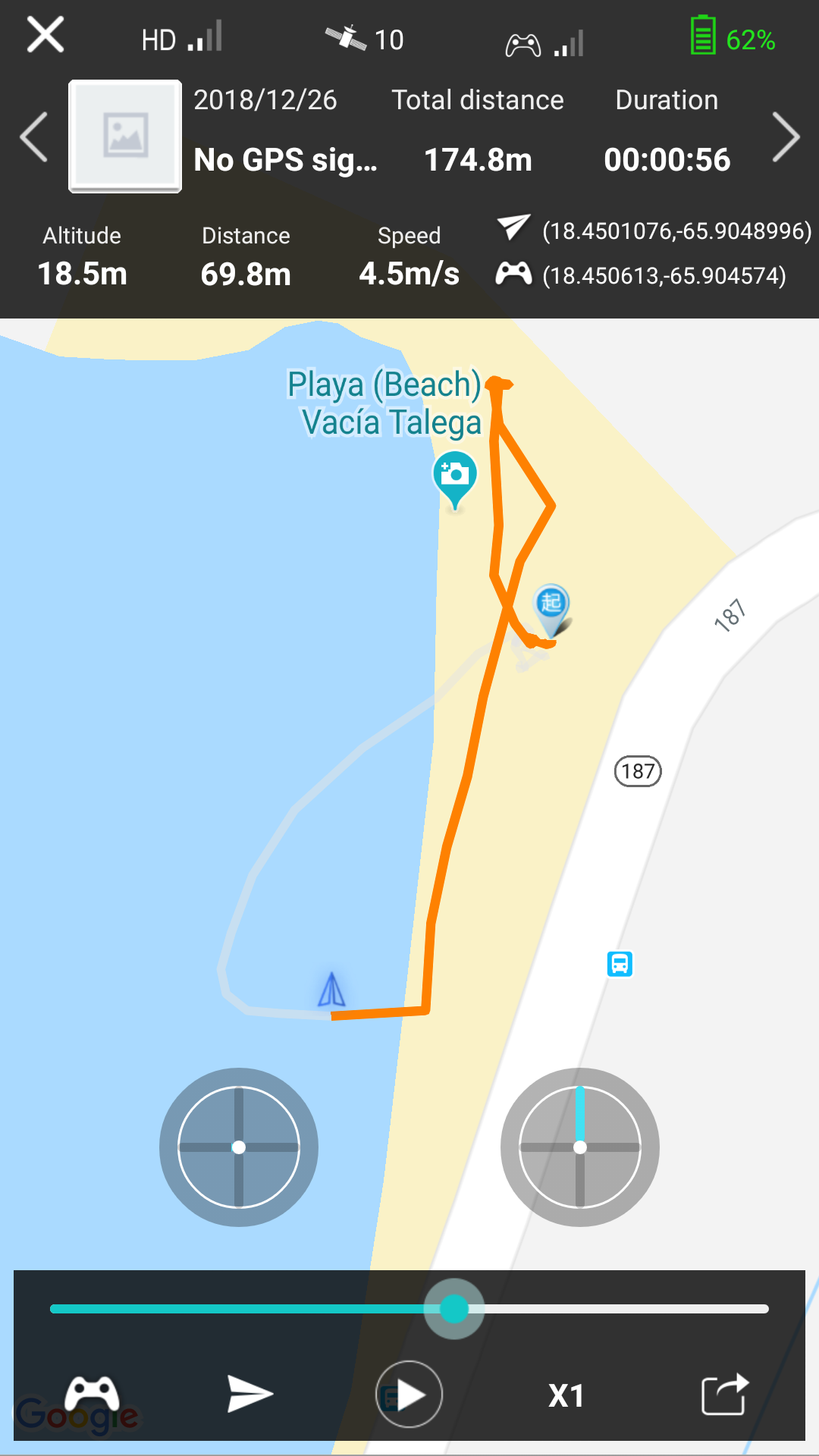

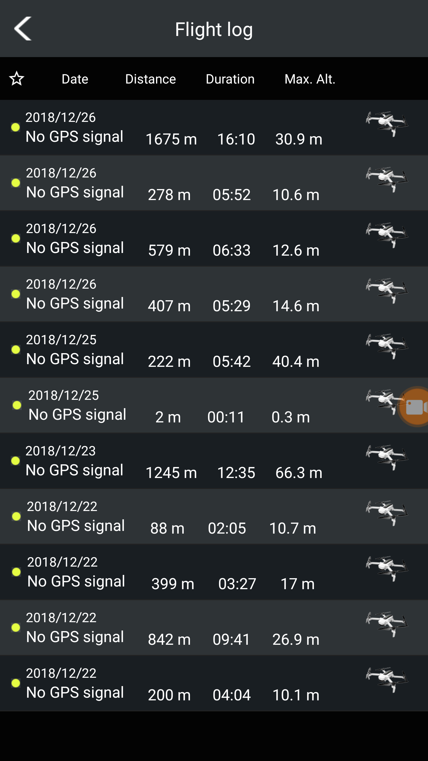

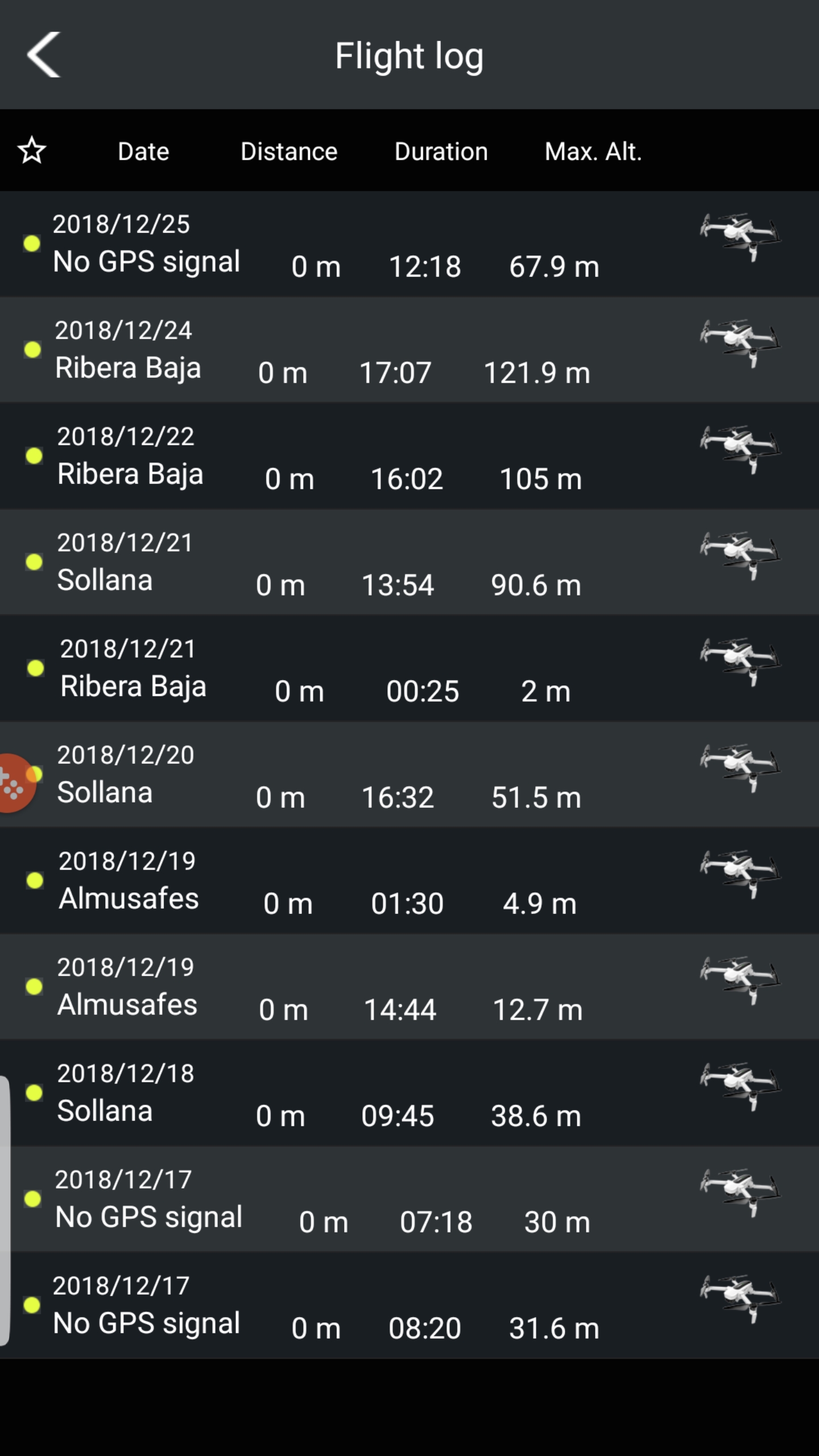

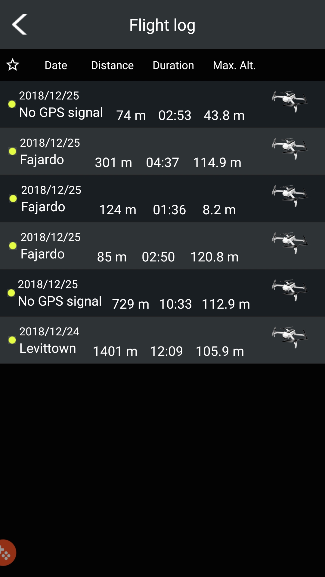

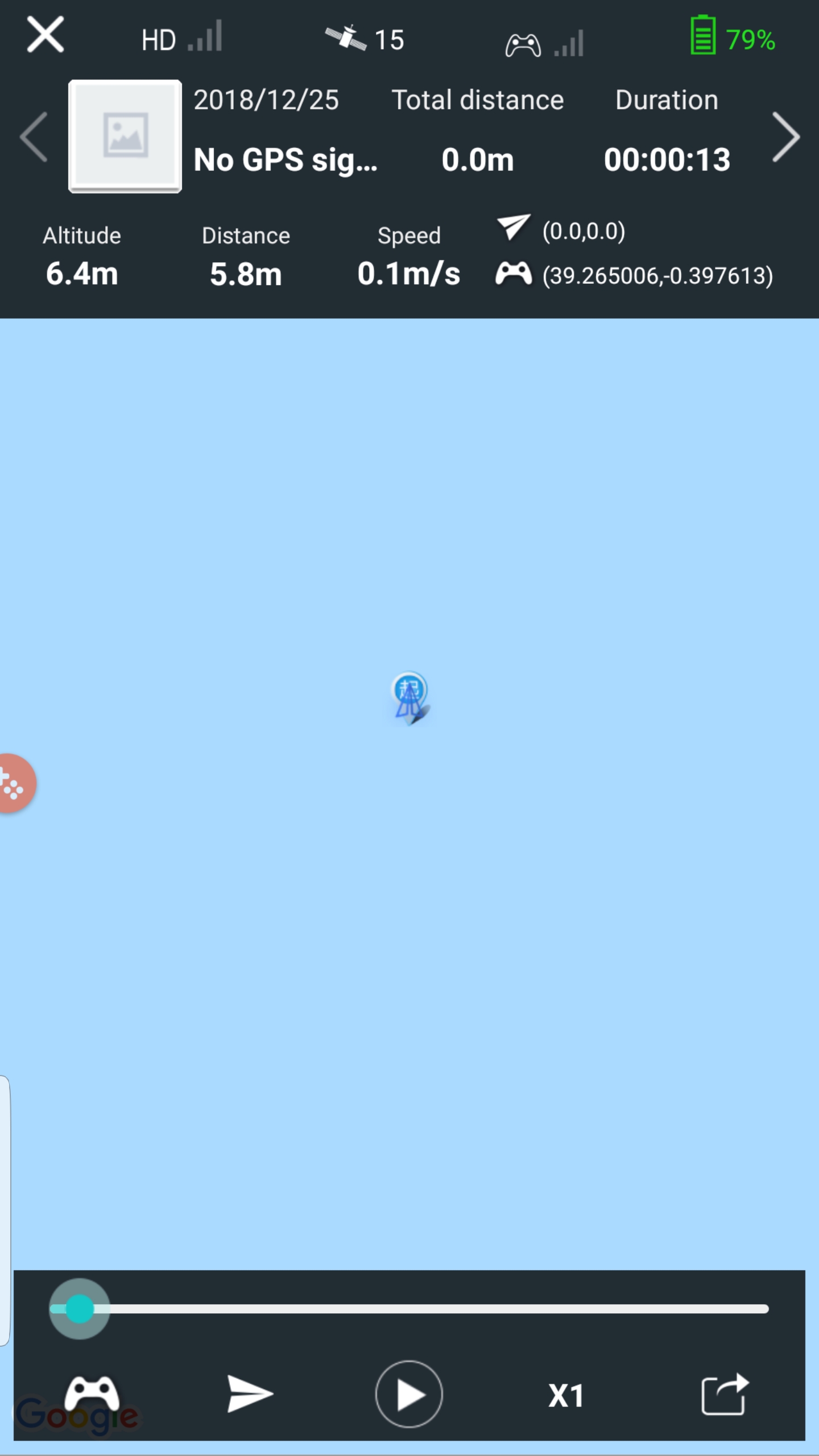

Post by gremaso » Wed Dec 26, 2018 6:56 pm
I think the No GPS refers to location. I mean, I have two phones and one has cell phone service and the other does not. Both have GPS enabled. On the one with no cell phone service (no internet) all flight logs say No GPS. On the one with cell phone service, it names the location.
No cell phone service
With cell phone service

ge_8efac33d06 wrote:
Wed Dec 26, 2018 4:02 pm
I also had mine drift away for about 5 seconds today over the ocean. I had the throttle full forward, but it drifted left until it started responding.
VERY SCARY
Flight log:
Video:
