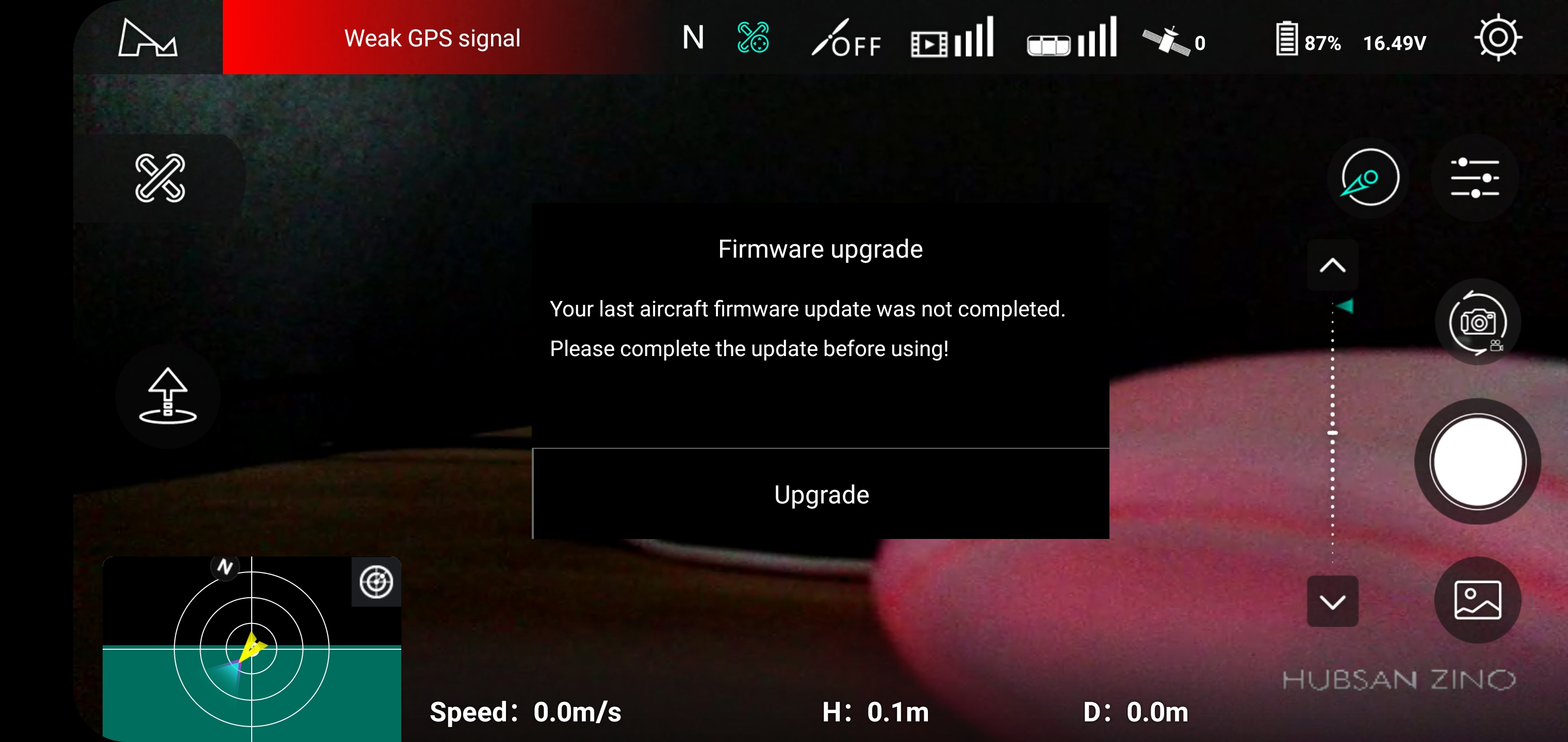

i try to update zino 2 whit the zino 2 app but the update have stop add 99%. and now i have a problem that i can not fly my zino 2. because the remote control is telling my that the update was not finish. update 1.2.3. the update is very big. what can i do for this problem. how i can resset the zino 2.

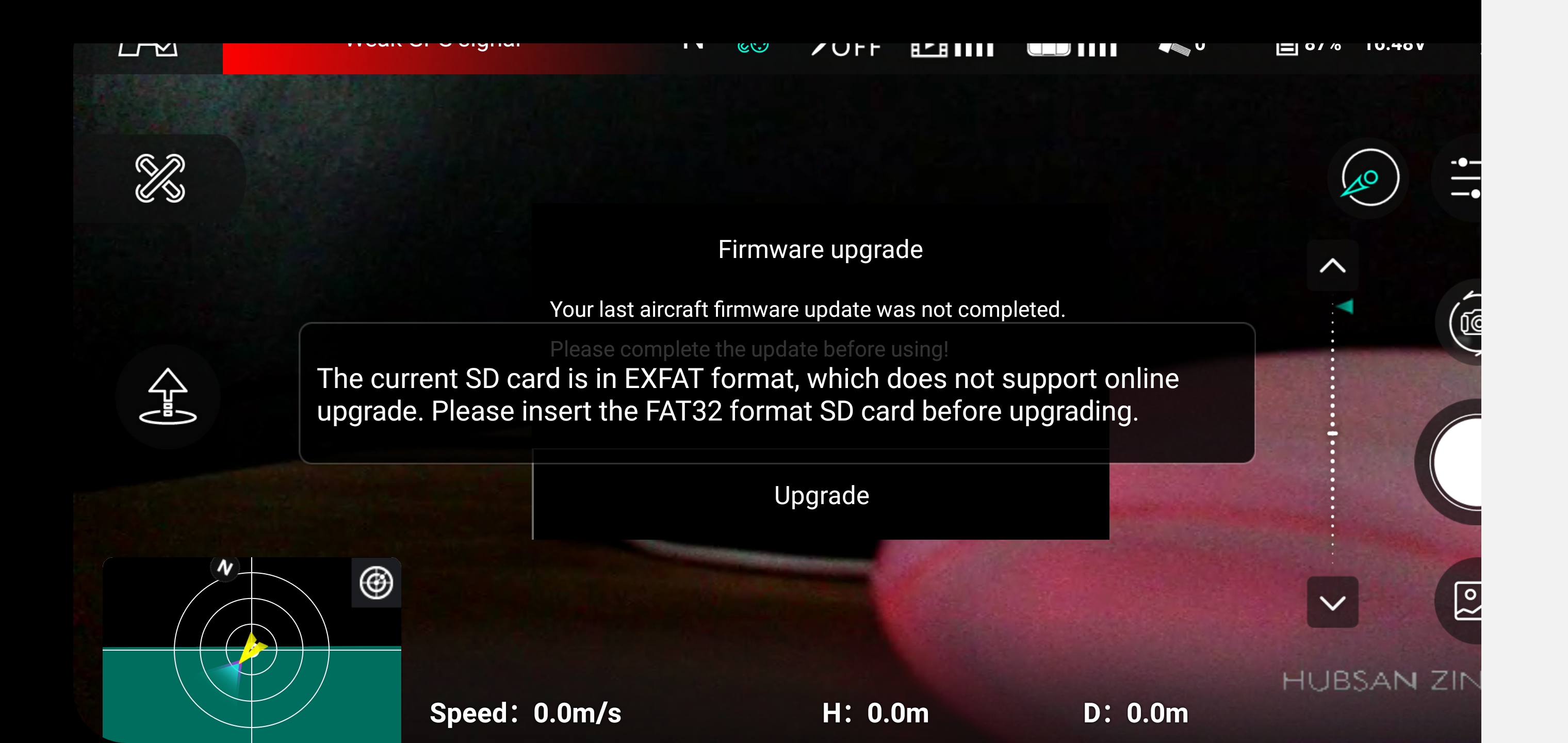

I have a similar problem, i ve started the update and then it said that it needs a sd card. It doesnt read my sd and I cant format it because when i login it shows the firmware update window l. Any solutions?

Hello guys, according message on image attached, you should format the SD card as FAT32. You could use a program called Ruffus, if you SD Card is more than 64Gb. But, If the card is less than 64Gb the windows is able to do that.
