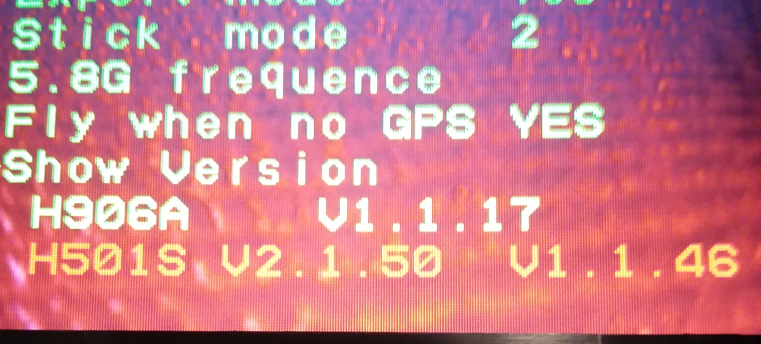

This shows it to be an S
Firmware 2.jpg (365.38 KiB) Viewed 25607 times

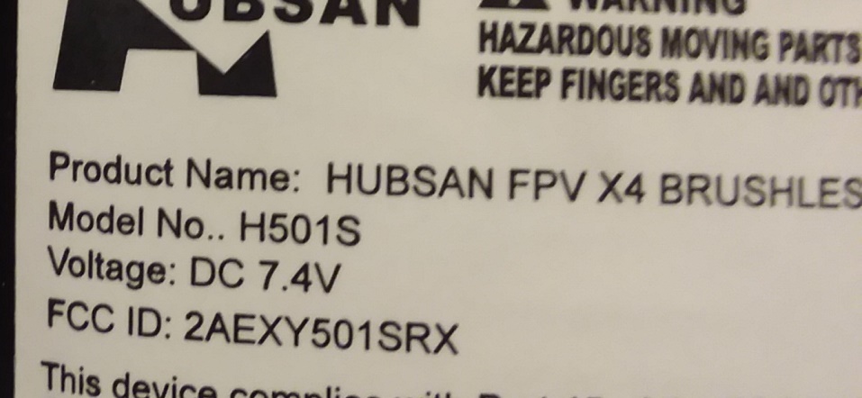

The label shows it to be an S
Big LAbel.jpg (111.76 KiB) Viewed 25607 times

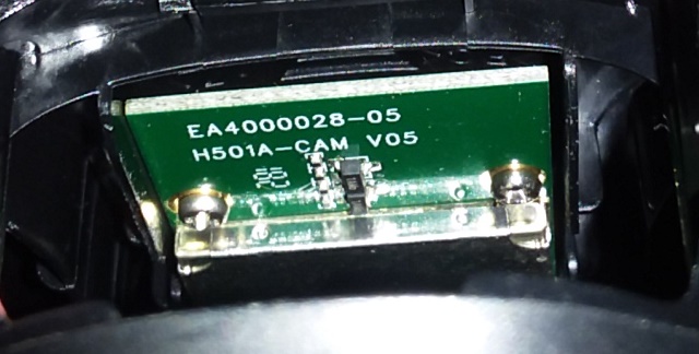

This is a SS model that is called the 501S on controller displays FC 1.1.46 is the indication that this is an S(SS) Model/ You can a;so look at the camera board and if new model it will say 501a Camera Board to tell you that you 501S is the latest vintage.
I don't know what Controller firmware release started Saying H501S vs 501SS but the camera board if it says 501A Camera board you have latest H501 model which used to be called the H501SS.
Confusing yes but if flight control version is 1.1.46 or above you can be sure that you have the H501S formerly referred to as a H501SS
