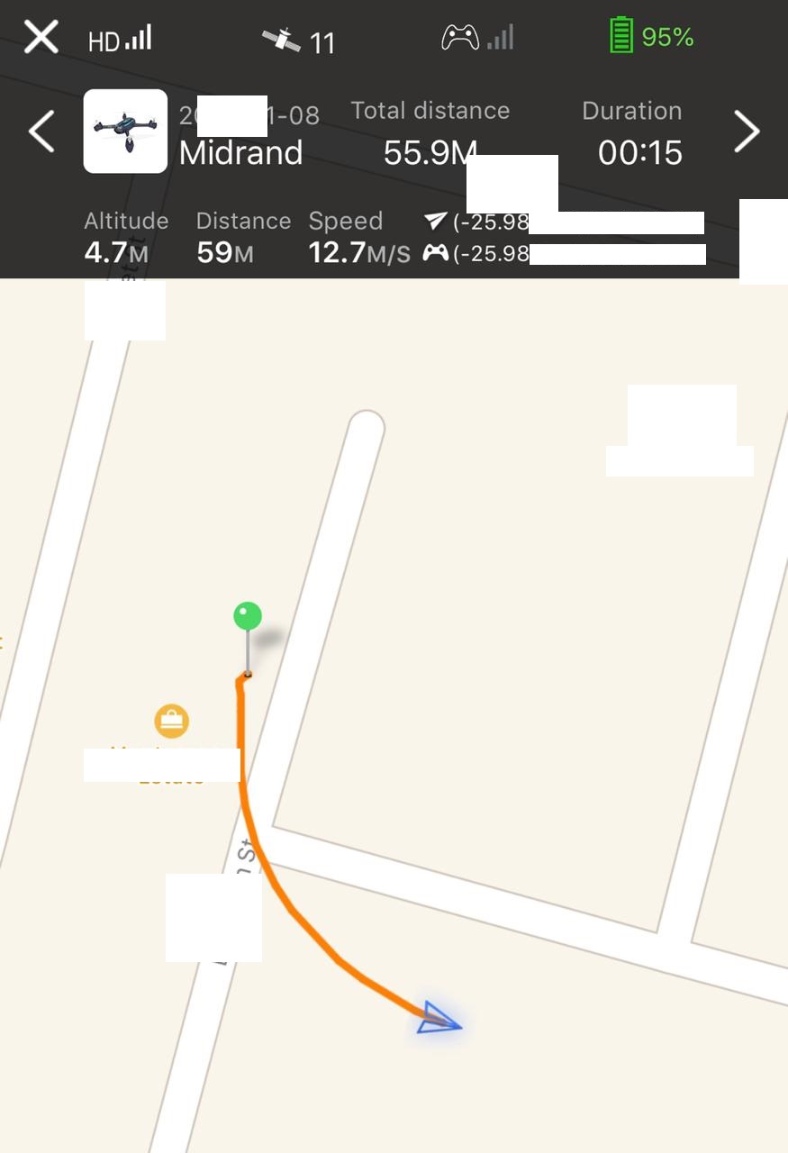

Hi there everyone.
I got a H216A and flew it 2-3 times before having some big issues.
It took off and lost control; it flew off wildly and as I launched from an elevated position it fell quite a bit.
I calibrated and checked enough GPS satellites first but this seemed to not be the problem.
After the crash it seemed fine but now when I fly it takes off and the left rear motor seems to lose power and the drone descends and bounces around on the ground. When its on the ground it seems to be landing on the left rear.
I can take off for a few seconds, stable flight till this happens and then its done and wont take off again.
Maybe it cools down and can work again?
The question is; can I just replace the left rear motor ( Left Rear is A type) or do you think something else is broken?
I'm happy repairing a "toy" as its all part of the fun. What else could likely be wrong?
