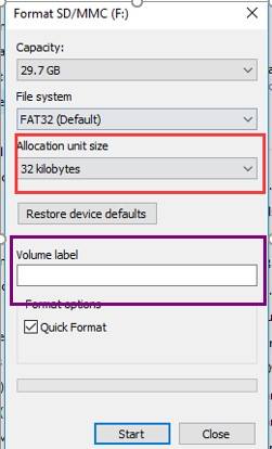

Please try to format the SD card to FAT 32.below attached the picture for your reference

Make sure the Volume Label area is blank. If it's filled in, there will be skipping. I suspect that's what's going on with your aircraft.
