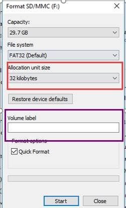

Post by Hubsan-Ailsa » Fri May 25, 2018 8:35 am
Kindly format the SD card to the FAT 32 as below
SD card format.jpg (16.09 KiB) Viewed 6685 times

Hubsan-Anne
Posts: 43
Joined: Thu May 17, 2018 1:41 pm
Re: SD card for Hubsan H501S X4 Brushless Drone
Post by Hubsan-Anne » Fri May 25, 2018 5:54 pm
Do make sure the indicated Volume Label area is blank.
