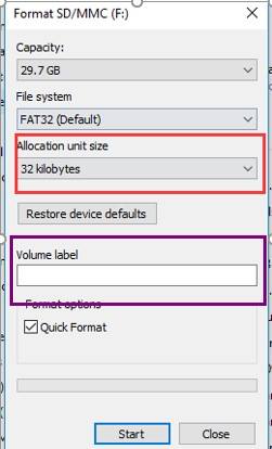

Post by Hubsan-Ailsa » Mon Oct 22, 2018 4:29 am
Hello,
The H502S requires for the 4-32GB SD card with class 10 or above.
Besides,kindly format the Sd card to FAT 32 as attched below
SD card format.jpg (16.09 KiB) Viewed 4398 times
