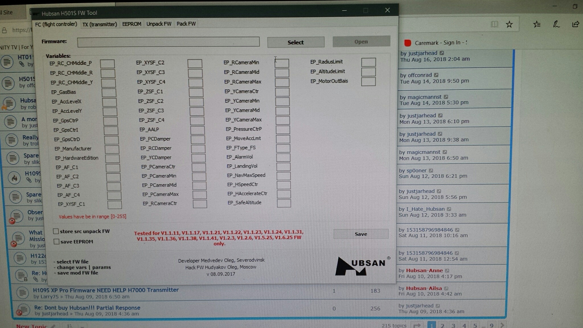

this is the easiest way. tell me have you tried this one?

What is the Firmware Version you are upgrading / modding. Neither method works for me and I am not downloading a new vwersion of firmware to my FC board. It is at latest so the method you suggest can cause loss of flight.magicmannst wrote: ↑Mon Aug 20, 2018 12:04 pmthis is the easiest way. tell me have you tried this one?

If you look at the bottom of the tool it does not support FC 1.1.46magicmannst wrote: ↑Mon Aug 20, 2018 12:04 pmthis is the easiest way. tell me have you tried this one?
So you cannot open the FC 1.1.46 hbs files , mod it and save.
SInce the tools basically flashes the EEPROM you can't load a compatibel FC version, change parameters and flash because when you reload FC 1.1.46 you over write the EEPROM. SO there is now way around for now.

Duplicate answer but I thought I would post anyway.magicmannst wrote: ↑Mon Aug 20, 2018 12:04 pmthis is the easiest way. tell me have you tried this one?
The mod tool cannot open the FC1.1.46 hbs file. It does not recognize it based on the version list on the bottom of the tool.
If you mod an older FC version and update you can save to an H501A but once you use the H501A Upgrade tool to reload FC 1.1.46 you overwrite the contents of the whole EEPROM so the changes made to a version the Mod tool understands are gone.
