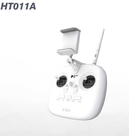

Dear Forum:
I have a drone H216A, and I want to know if it is posible to extend the range of the signal.
I have opened the FPV HT009, and I didn't see where is the antena into the circuit.
Sorry for my english, I´m from Argentina.
If is possible to that??, show me how to do it.
Or How can I get the FPV HT011A, because I see is more complete, and have an external antena
Sin título.jpg (18.09 KiB) Viewed 5673 times
Thanks in advance

Jorge,
I believe that the HT009 is a WiFi controller that works in conjunction with your Wifi H216A Quad so it does not have a traditional antenna.
To extend range you can go with the HT011A controller but range may be limited to under 400 meters depending on the WiFi signal from the H216A.
Flight with the HT011A will be identical to your HT009 only with a better controller with extended range.
The antenna on the HT011A is for it 2.4g signal and does not apply to WiFi APP flights.
The HT011A has an integrated WiFi relay that does extend typical WiFi flights considerably and can be bought on the internet in the US for under $50 USD. I don't know what Internet sellers sell it for down there but it can be purchased from Hubsan as a spare part.
