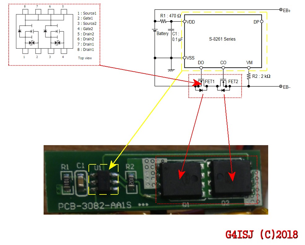

The battery circuitry simply uses a couple of FETS, equivalent to the ECH8601.
These are kept "closed" during normal operation and are in series with the power connector.
The sensor circuit is based around the S8261, (or equivalent) which senses overcharge, over discharge and over current.
It simply "opens" the FETS which then remain open until reset.
The terminal voltage presented to the user is therefore zero.
I have a Hubsan Battery that is over 26 months old with this protection circuitry. I believe they have been shipped as such since day one (which would be approaching 30 months now. The most recent "genuine" Hubsan battery I have is 10 months old and also has the circuitry.
"Fake" Hubsan branded batteries do not incorporate the circuitry.
The popular replacements also do not implement any protection circuitry.
battery protection.jpg (106.04 KiB) Viewed 12645 times

Thanks Pete. I appreciate you input and knowledge.

Re: Battery Protection Circuit on 2700mAh 7.4v Hubsan Batteries. Please Explain
Post by gjvo » Sat Aug 04, 2018 5:16 am
As i told,
It is a protection when you are charging, not discharging.
So, a battery management system.
Overvoltage, overcurrent and overcharge protection.
Here is the datasheet of the chip.
https://www.ablic.com/en/doc/datasheet/battery_protection/S8261_E.pdf
GJ

ParadoxPete
Posts: 4
Joined: Fri Aug 03, 2018 3:21 pm
Post by ParadoxPete » Sat Aug 04, 2018 6:24 am
It protects against overcharge and overdischarge (min and max cell voltage),and overcurrent.
Overcurrent is the issue that is being talked about in this thread primarily, although minimum voltage could occur under certain circumstances.
Post by gjvo » Sun Aug 05, 2018 8:23 am
Yeah, with overcurrent they mean the current that is going into the cells during charging, not what is going out to the motors.
So you cannot charge it with probably more than 500 mA.
It is also not advisable to do more on the balancer connection.
If you want to charge by the "normal way" like all modellers do you have to charge it by the blue EC3 connector, than you can charge it in 45 to 60 minutes.
And if your balancecurrent is lower than 500 mA than you can leave the pcb in the battery, if the balancecurrent is higher you have to take it out.
GJ
