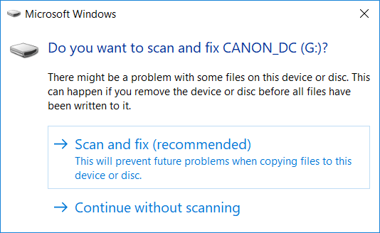

I should also point out that when I plug the memory into my PC, Windows always reports that there is something wrong with it, and wants to scan and fix it. Usually I let it do so, and no problem. I don't know if the scan and fix caused the data corruption I mentioned in my original post, but I doubt it, since it's happened every time. Here's the message:

Hi, did you finally get to fix the corrupt files problem? I seem to be having the same problems occasionally. New user so any help would be appreciated,East Sussex here.

Post by Hubsan-Anne » Mon Jul 16, 2018 6:02 pm
Try reformatting with a GoPro, or a Windows computer with the following tutorial: https://www.facebook.com/hubsan001/posts/1785092691795746
