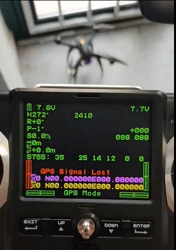

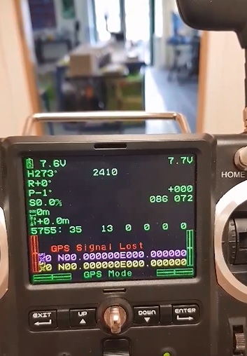

My first post on here, i have an H501S, i have lost the FPV the camera records and take pictures (i dont have the "recording" on the advanced controller but the button to take a picture or video work? all batteries are fully charged.
Couple of things tested:
1-I have an 5GHZ video sender and the controller picks up the signal so this must be working correct
2-Put in into test mode
numbers that appear at the start (close up)
+000
096 092
5755: 35 21 16 15 0 0
Around 8mtrs away numbers read:
+000
090 072
5755: 35 13 0 0 0 0
I have checked everything is connected inside the drone, does this sound like the Video transmit board?
Regards
Paul
+000
096 092
+000
090 072
5755: 35 13 0 0 0 0
Regards
Paul

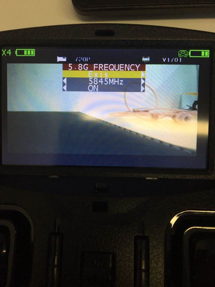

Hello ,may I know if you set the 5.8G frequency option on?
Besides,would you mind to show the video for demonstrating the data which entering the test mode?
- Posts: 1027
Re: H501s No FPV/ Black screen
The way to set the 5.8G frequency on as below
- Attachments
- 5.8G frequency.jpg (71.45 KiB) Viewed 15294 times

Hi i have the advanced controller, below are pictures at the start and the end of the video, i cant upload the video???

Back to Basics #26: How to troubleshoot FPV issues, part 2 https://www.facebook.com/hubsan001/posts/1796671740637841
See if the aircraft will take photos and videos with a properly formatted SD card. If the 5.8G signal power is a 0, that's a clear 5.8 module issue.
