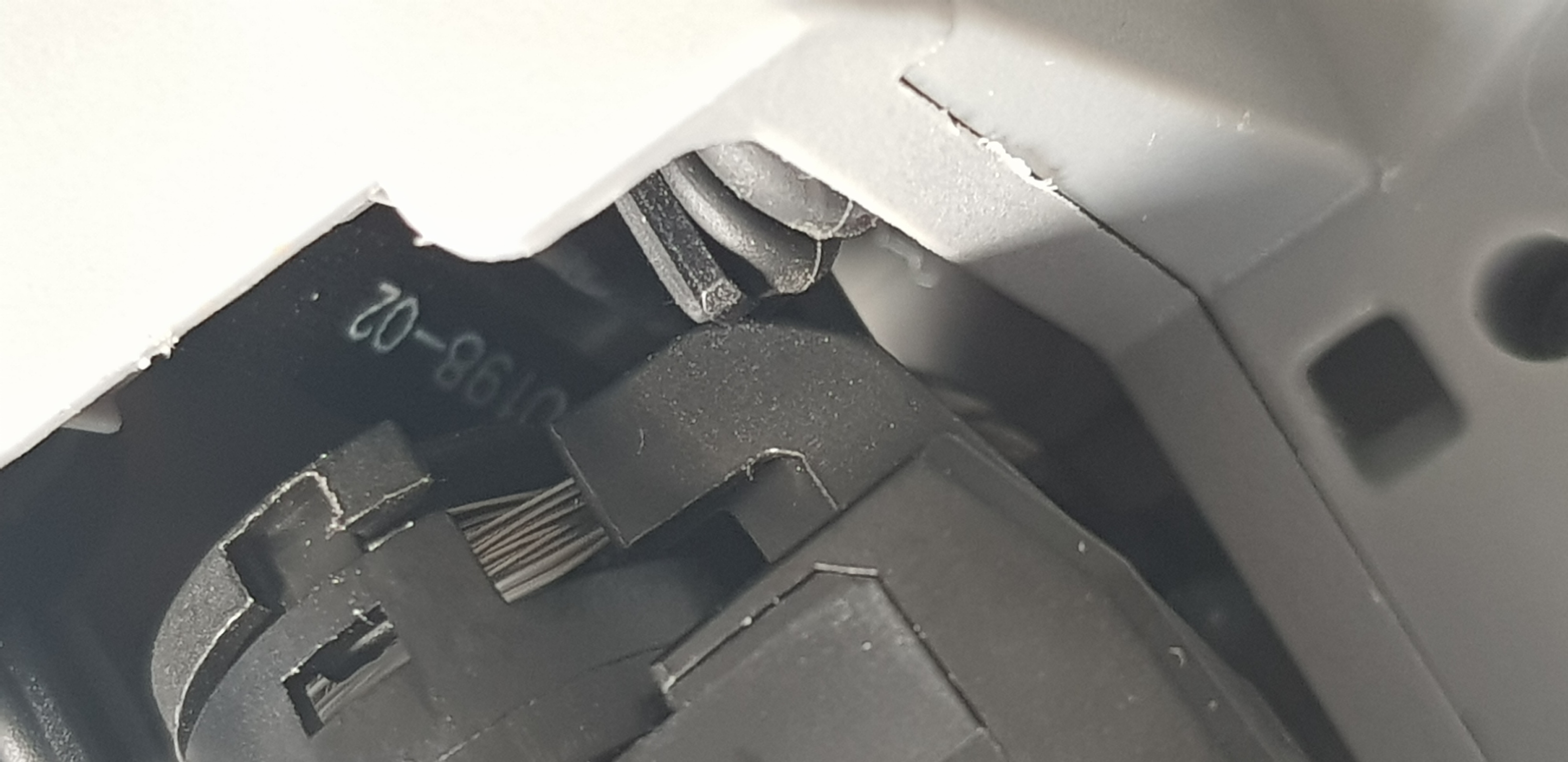

I think I have found the twitch issues... my gimbal appears to actually catch its mounting points in some positions! See photos. Can anyone else move their gimbal in a way that causes it to catch its own hanging bracket?
