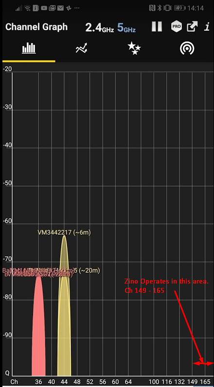

To put things in perspective. Here's what the 5G Wifi band looks like where I fly. This is exceptional to see 3 signals. However in Europe you'll rarely see anything in Band C where the Zino operates (Ch149 -165) as most devices are not enabled for it.

No. Because this is a screen shot off my phone.
I live in europe where mobile devices do not generally have any access to Band C.
This is the point I'm trying to make :)
There is generally no traffic in Band C in europe, whereas in other parts of the world and especially USA, it is widely used.
