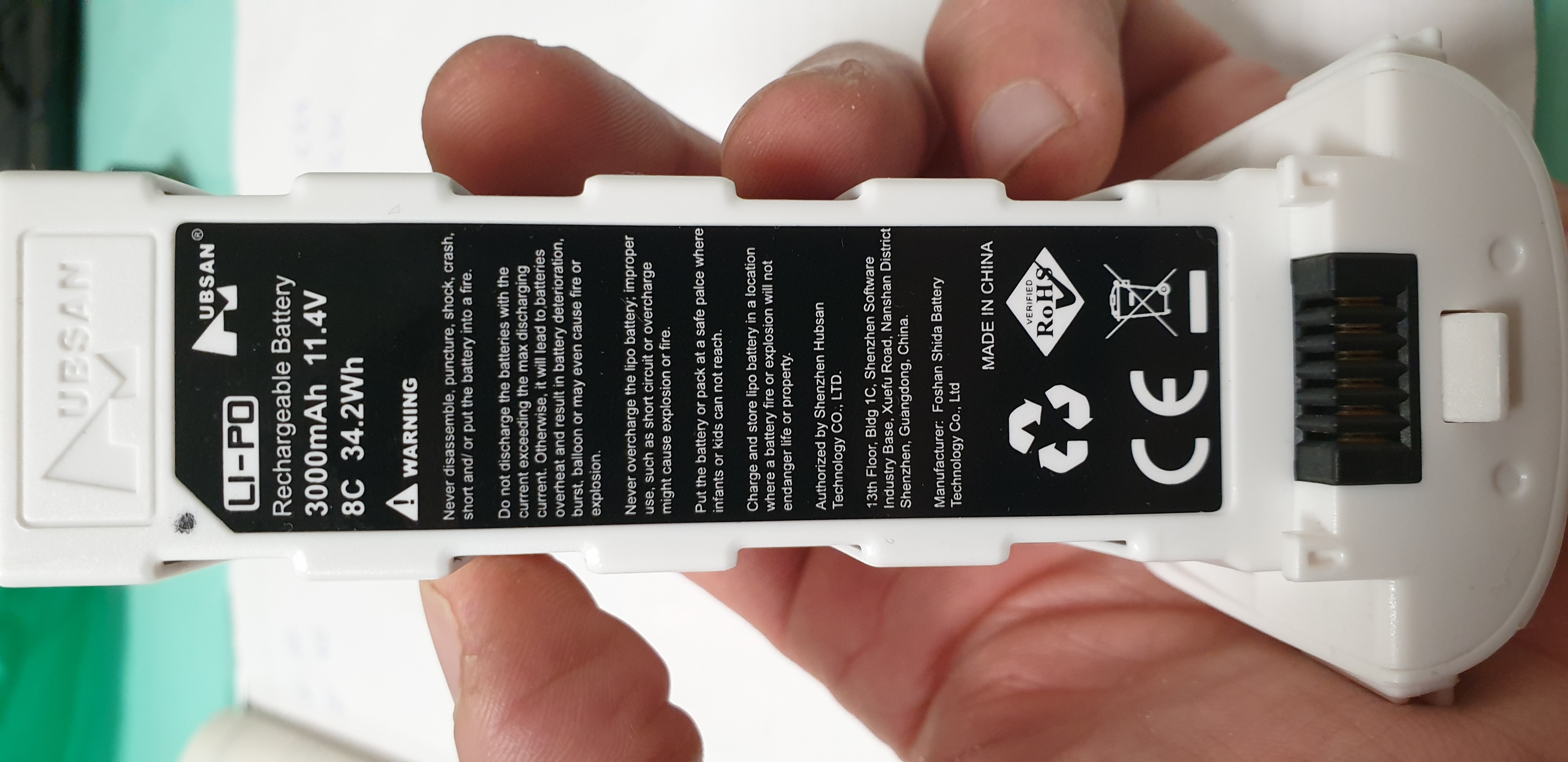

Why do you keep saying it's a LiHv battery when Lipo is written on it?
How should I load, lipo or lihv?

LiHV is Lipo High Voltage
So yes, it is a Lipo but normal Lipo's are charged to 4.2V while High Voltage Lipo's are charged to 4.35V
You can charge LiHV with the LiPo program but than you will not be using the full capacity.

Most chargers let you choose final cells voltage, so even li-po program should be ok.
