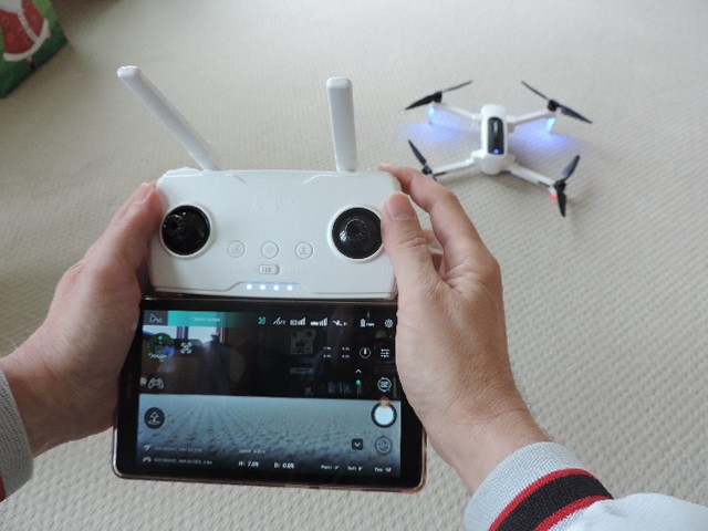

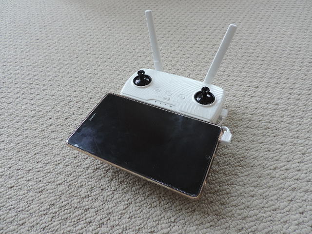

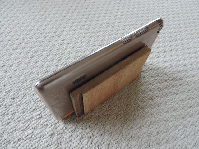

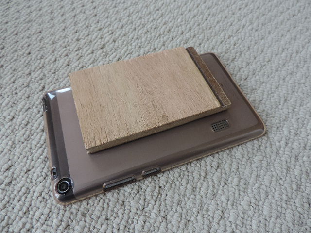

Are you referring to the iPad being too large to fit?
I wanted to use my Huawei T3 7" MediaPad, but it was too large. I found a thin, cheap cover for the MediaPad, used a little flooring sample found at home improvement and flooring stores as a spacer, and attached the sample to the back of the cover, using Command strips. What to use as a spacer or how permanently you want to attach it is up to the user; I found the free flooring sample and Command strips to work just fine, as shown in these photos. This will work for 7 and 8 inch pads; I'm not sure about bigger items. The controller clips onto the spacer, with the pad stuck on top.

No, it's light enough for the wrists, and you can see all the controls.
Notice how you hold the controller with the pad attached. This is an inexpensive solution, and works for smaller pads, not for 25cm/10" or larger pads. In those cases, go with your idea.
Now, if you have small hands or weak wrists, well, I can't help you there.

Nice! Very creative!!!
