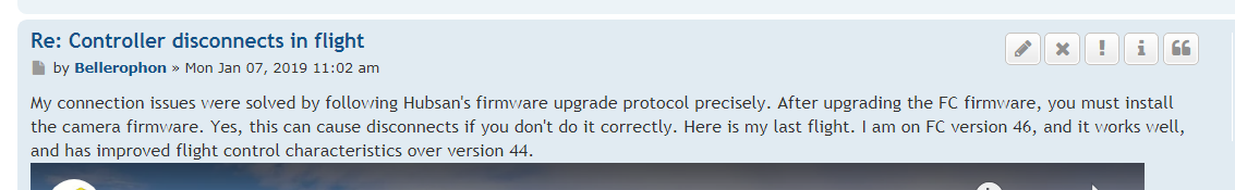

Hello irussphone,
May I know if you update the all Zino firware to the latest one(FC ,Gimbal,IT firmware)?Kindly remind that format the SD card to FAT 32 when updating the IT firmware.
This customer Bellerophon solve his disconnect issue.Hope will help you
- Attachments
- Customer solution to disconnect issue.png (34.18 KiB) Viewed 9076 times

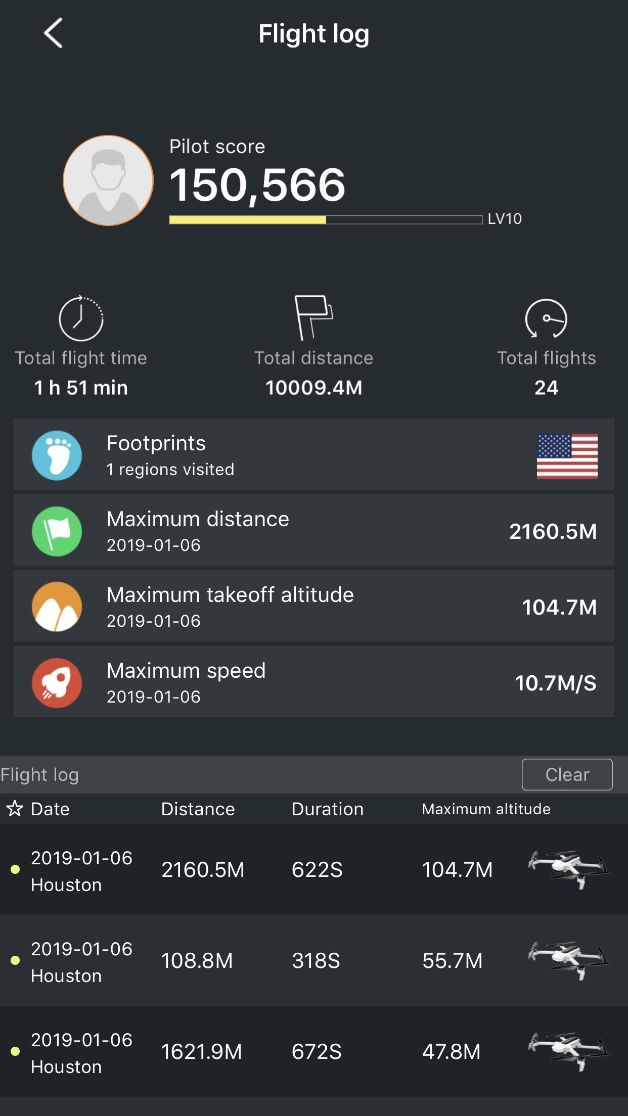

P.S. Here is also my flight log for the Zino so far...
- Attachments
- Flight Log.jpg (271.92 KiB) Viewed 9030 times
- Posts: 1027
Re: Won’t stay connected
Hello Russ,
Thanks for your feedback
We reviewed that you take long time to pass the GPS accuracy in the video.Kindly suggest you take the phone and moving within a range of less than 5 meters from the Zino to pass the GPS accuracy.Hope will get the good GPS accuracy quickly.
- irussphone
- Posts: 256
- Location: TEXAS
Yes I saw that too but the controller was within .5 meters the whole time, plus I had over 12 satellites available so I don’t know why that was happening. It’s part of the hardware/software problem for Zino engineers to solve.
It does not happen with version 1.0.44. ???
