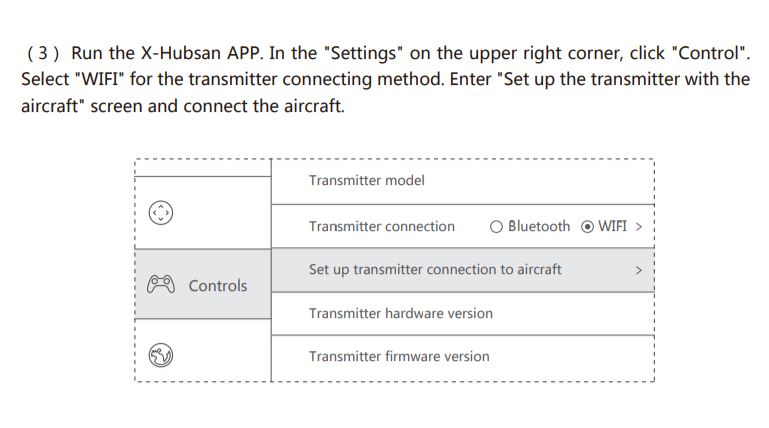

But on the hubsan's android connection tutorial is said to be wifi as an option. The USB cable's purpose is only for battery charge for android connection. And the connection option says you should select wifi. I don't understand this point. If connection is made with wifi, the short distance will fly. But when we connect with cable how can we fly? Cause we selected "charge only" selection. I'm confused.
this is their suggestion: https://www.hubsan.com/support/files/products/ZINO/ct/connectTutorial.pdf?fbclid=IwAR2HwjhWw4ToJIvbKo6H9kN1ofsfTK0BGWS5HJknitfcLHMHLpwV7i_BZpo

No the WiFI option is for how the transmitter connects to the quad not the phone see page 10 of the connection guide. If you connect the phone via WiFi you are flying phone alone no transmitter boost, range will be about 200m.
Correct. The manual is so so vague. But,do not,I repeat,Do Not,connect to the WiFi. Turn off the WiFi on your phone
