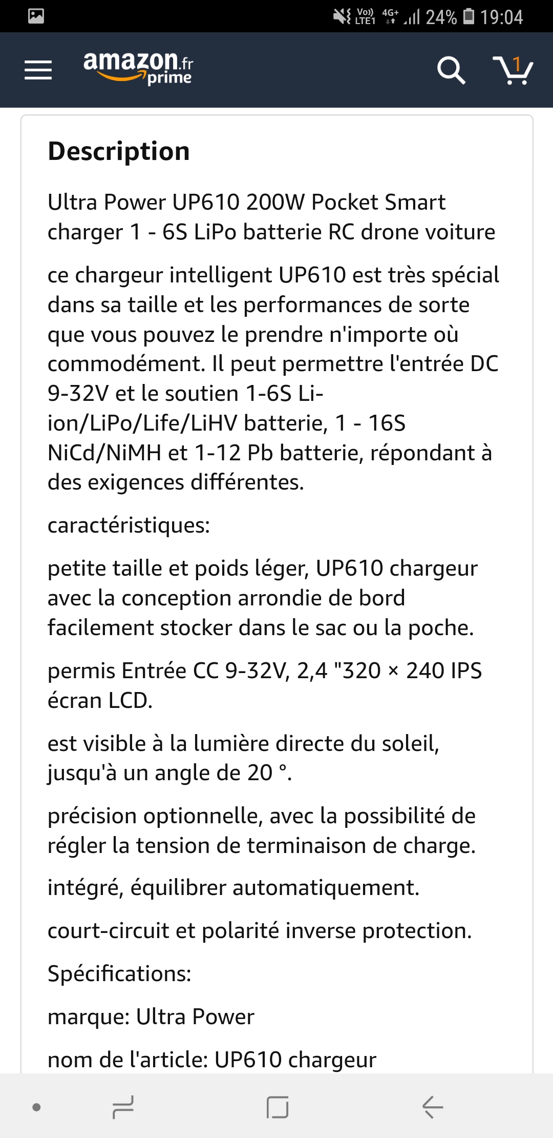

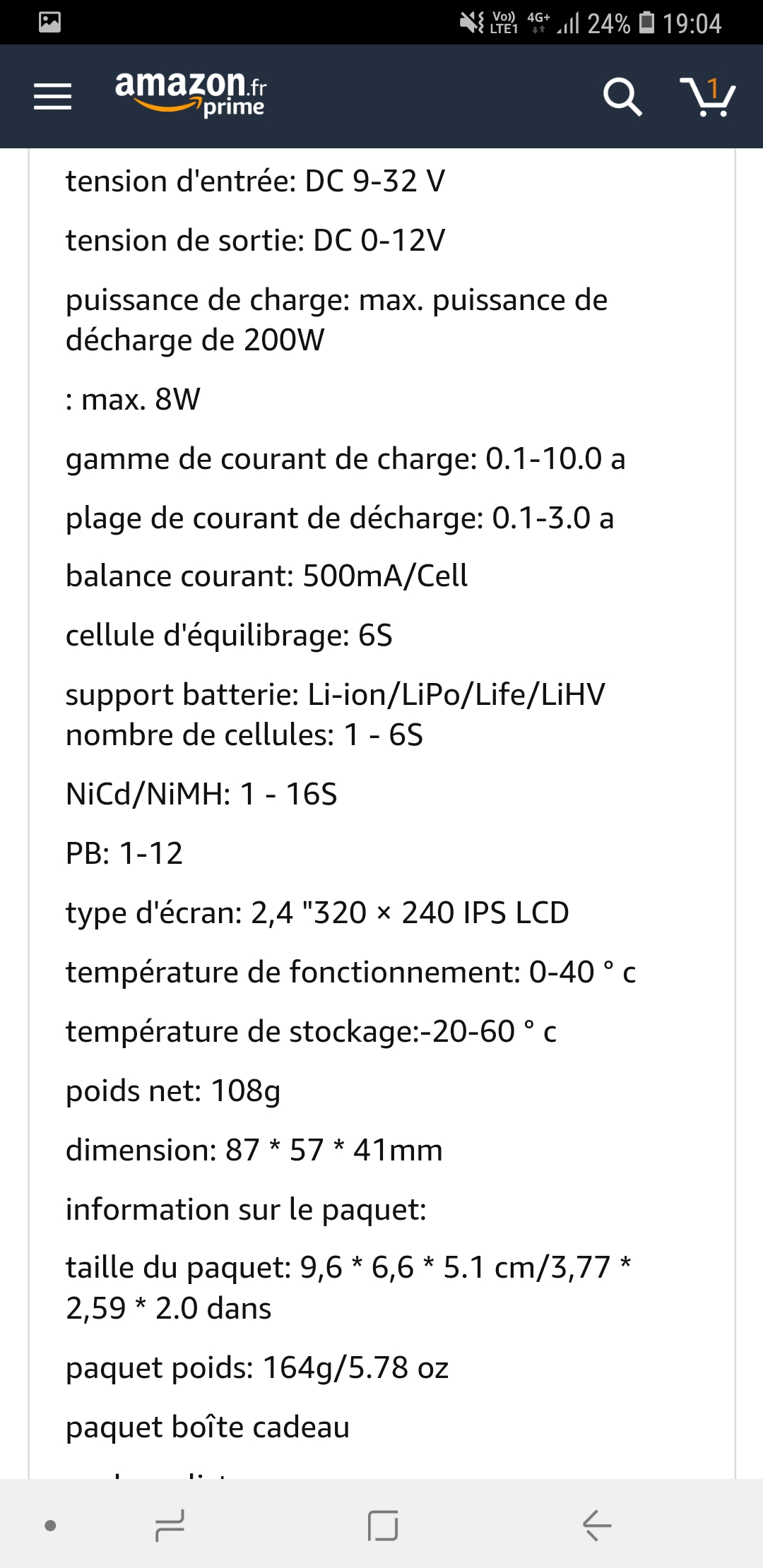

charger balance UP610 is best or not for battery zino
Post by Sparty3108 » Thu Dec 20, 2018 1:26 pm
for battery zino it's ok or not
win time to charger ?

Re: charger balance UP610 is best or not for battery zino
Post by MrDronenut » Thu Dec 20, 2018 1:39 pm

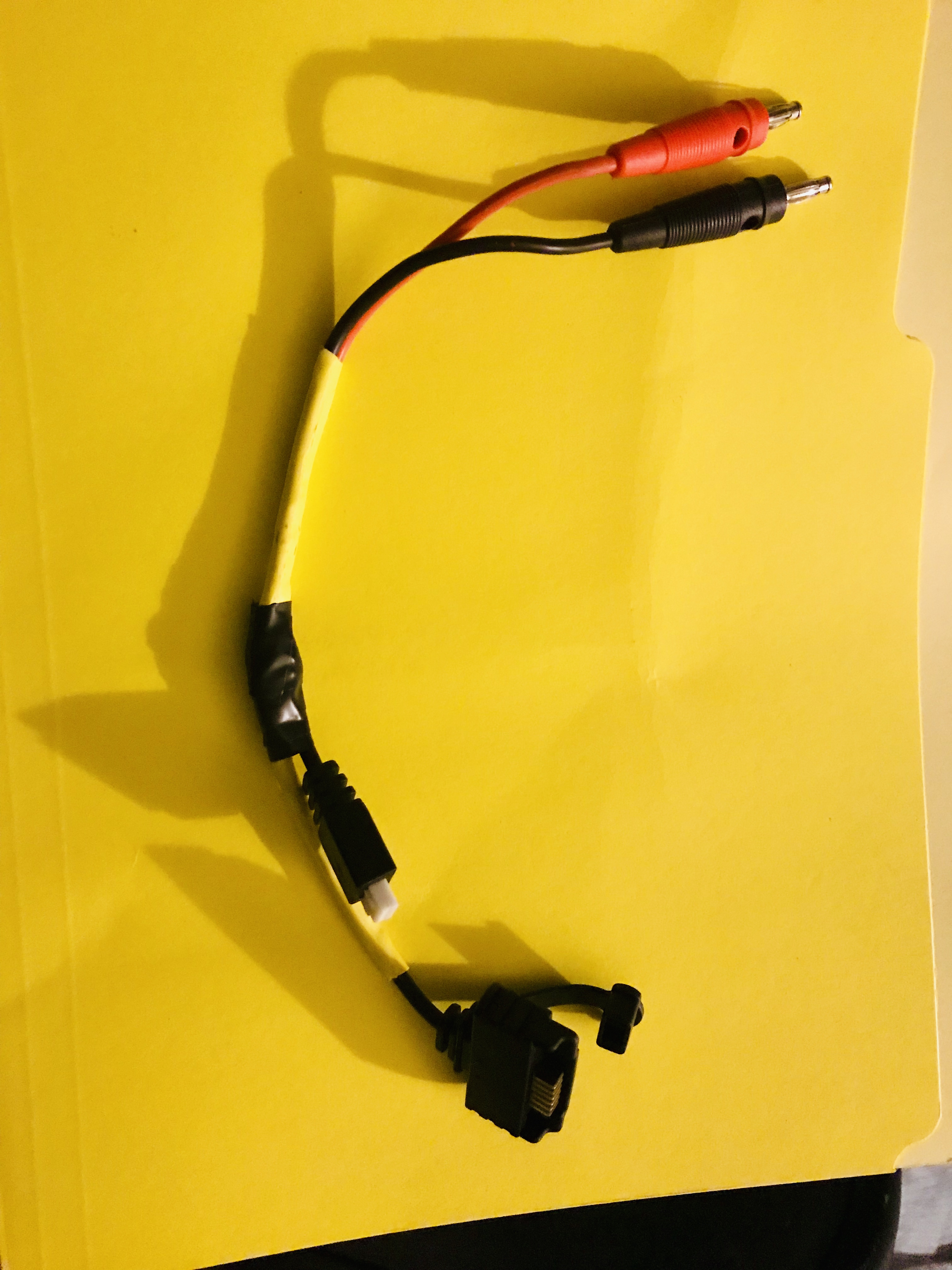

The Zino. Battery is not a LIPO,but it's a LIHV(lipo high voltage),which charges it to 4.35 per cell,instead of 4.2 per cell.
Do the charging cable mod,and use a charger capable of charging a LIHV.

Good info, I have a LHV lipo charger...how to make a charging cable mod?

Charge Cable mod...Russ
irussphone
Posts: 256
Location: TEXAS
Post by irussphone » Thu Dec 20, 2018 10:31 pm
Here is mine...
