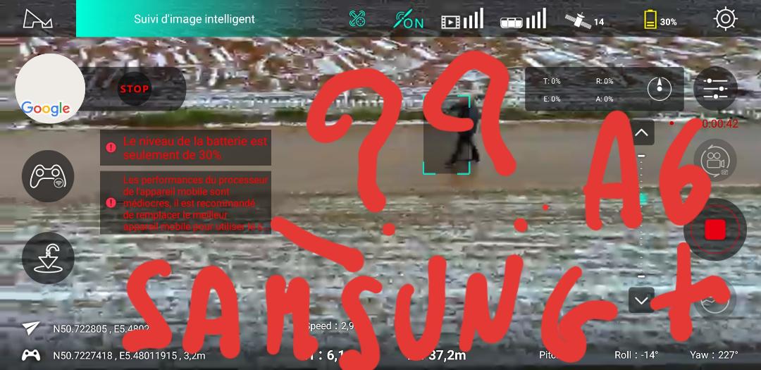

hello hubsan what should i understand that my samsung A6 + 2 months only is a bad phone for zino. see photos????
impossible to make flights in radius and full sky as well as other anomaly to see attached ... ??????
the application not at the point at all.
frankly a goodbye
help help hubsan
you need a super gsm for the zino

The A6 is a mid spec phone and should be able to run the Hubsan app, make certain all background apps are off before using it with your Zino.

Re: you need a super gsm for the zino
Object tracking is operated by app. App process the image and move the drone. İmage processing job takes too much system sources. İ recommend close all aplications background.

Hello Sparty3108 ,
If the phone is hot and the CPU is not moving when engage the image tracking .The APP will have anomaly .which means the mobile device CPU is fully loaded, Kindly recommended to turn off the image tracking function.
Waiting for your further feedback

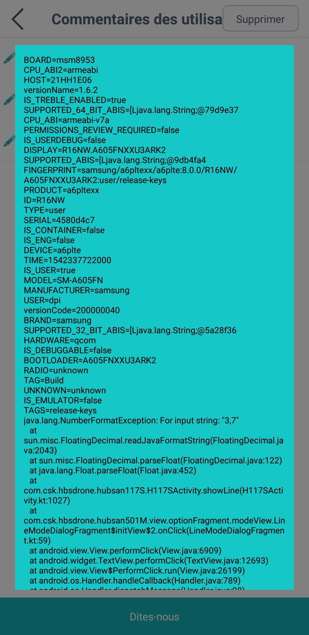

From the look of the log you had a Floating Point Error in Java on the Hubsan App. If it happens continually try uninstalling and reinstalling the app. Otherwise it might just be a random crash.
thank you for your answers to all 2
I have already tried several times the "LINE FLY MODE" it was every time ANOMALY and also that 1 of the 3 panorama mode ???
I do not know if it's a processor problem for the "Follow mode active track" I agree especially as a message indicates.

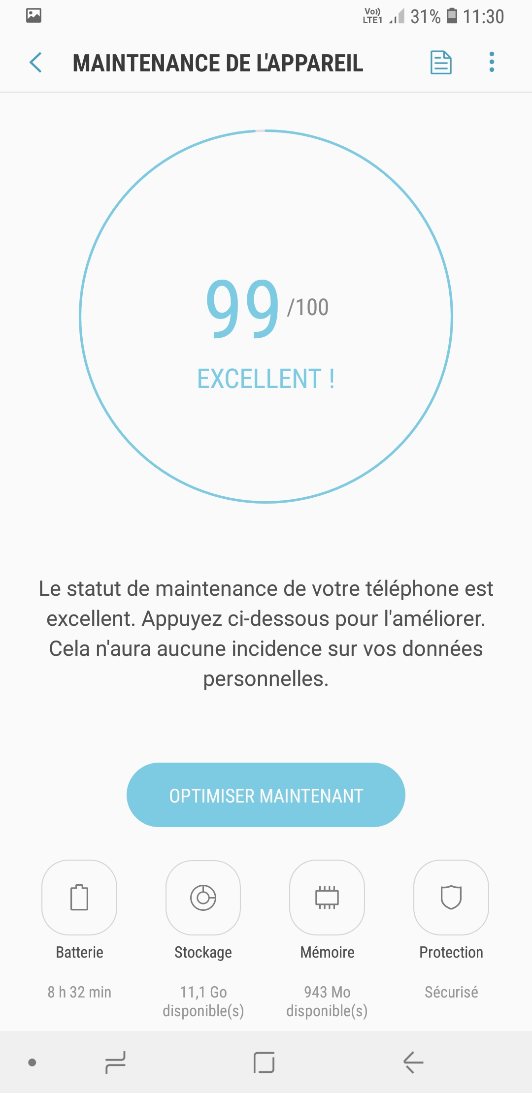

i try ......a lot .......a lot .....a lot evrytime the same message.
my Cpu ok and the message come again that the cpu is bad??????
