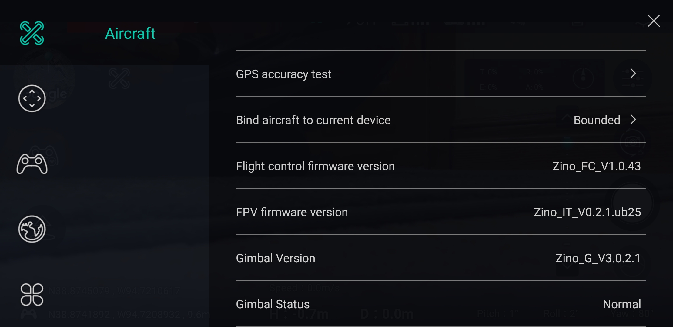

For this Zino toilet bowl effect,Would you mind to provide a picture of your Zino FC firmware for us ?Just for better checking.
Besides,may I know if you do the horizontal calibration firstly then do the vertical calibrtaion?

Here is the pic for firmware. Each time I did horizontal caliberation first. See the video for both times. I have not flown in long as I am concerned.
