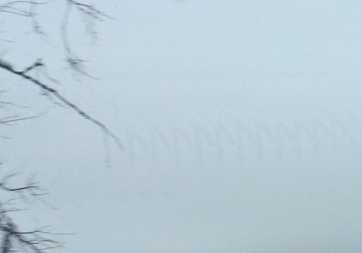

I don't think the Zino camera even has any focusing capabilities, it's just set to infinity focus as most action cameras are. Also it would look as if the "still" mode of the camera merely captures a video frame, the resolution is exactly the same and there's no EXIF data in the file at all. Thus, fiddling with compression settings would bring very little additional benefit.
The worst problem seems to be the white balance, it's really visibly changing when the scene is changing, it's like a flick of a switch. Also there is some relatively aggressive noise reduction going on, in darker scenes there are some visible artifacts stemming from this (streaks, motion blur).

Post by me_075d7ydEYr » Sat Jan 05, 2019 11:11 am
Please see attached file, such streaks are easily visible when panning for instance. This is from a tree branch. When ascending from behind some trees, the whole forest leaves a noticeable blur against the sky.
Streaks from the camera whilst panning
