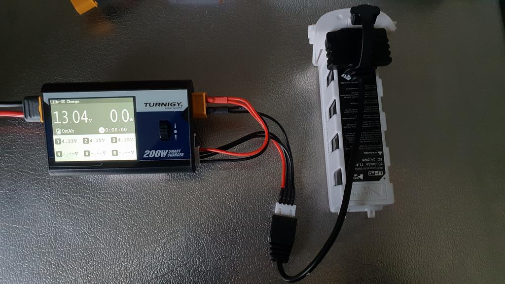

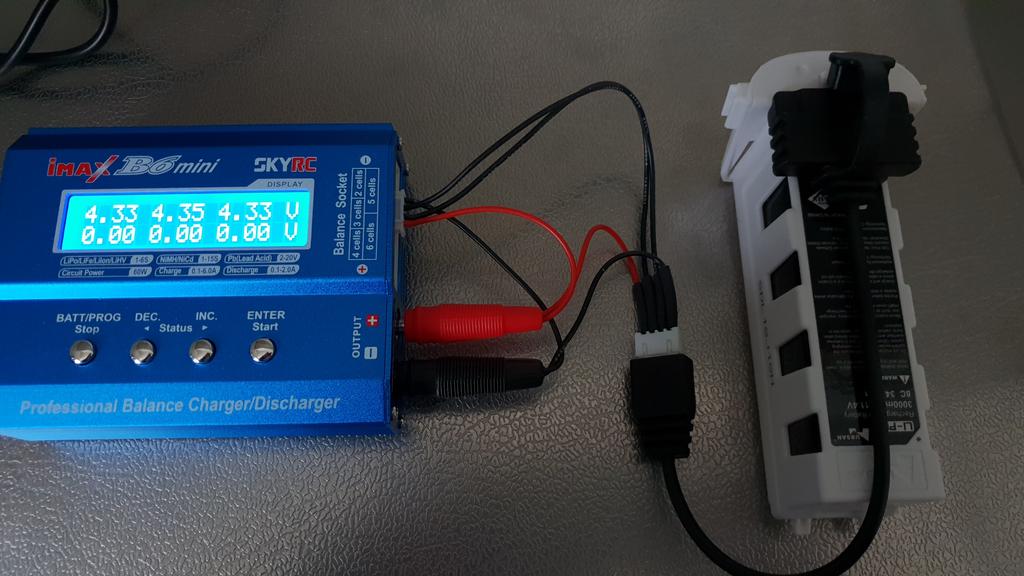

Well, the video clearly shows that the cells are still unbalanced so I would say that the charger is not working as it should. You can try to discharge the battery by flying for a while and than charge again to see if anything changes but personally I would invest in a good 3rd party balance charger which in my opinion is a good investment anyway.
I can certainly recommend the original SkyRC B6 or B6 Mini or the newer technology Turnigy or Ulrapower UP160

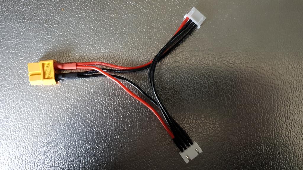

You can very easily make an adapter cable in 2 minutes from a standard 3S balance extension cable.

thanks I had already opted for that solution but I'm waiting for cables from amazon. Meanwhile, the loader has already arrived:

Good choice!
For that charger you want the adapter cable like this (XT60 connector instead of the banana plugs):

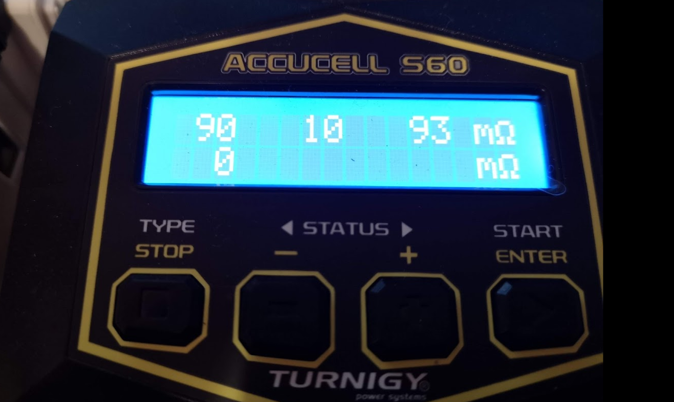

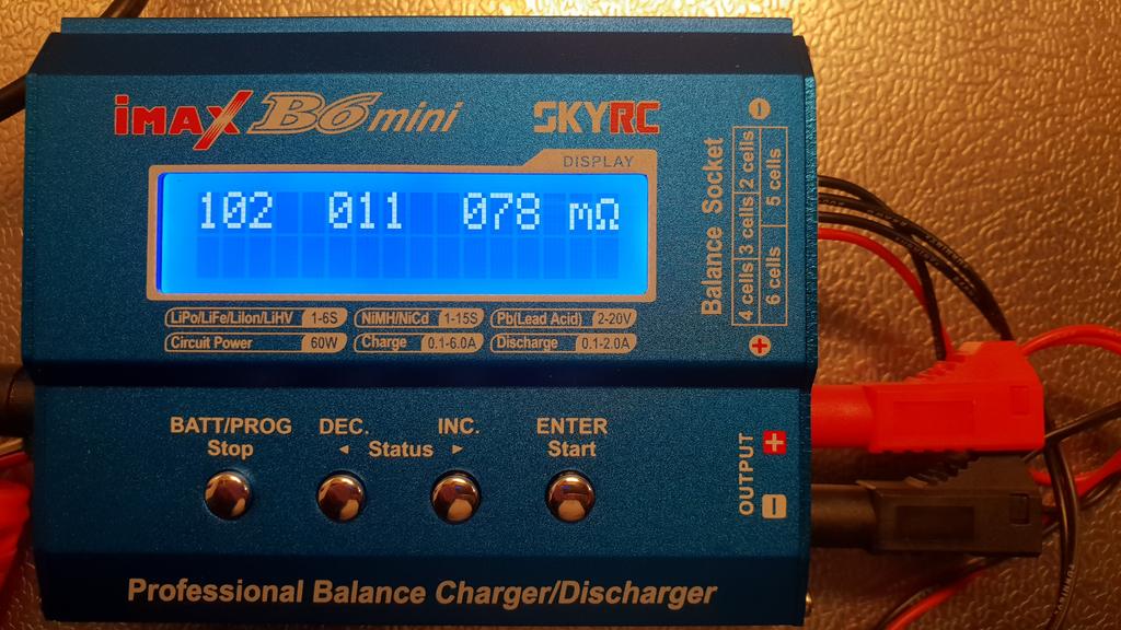

I've asked before, but is anyone prepared to share their Internal Resistance measurements for these packs.
I'm interested in whether I'm just unlucky on getting 3 mediocre batteries ;)
fvdk
Posts: 28
Joined: Sat Oct 27, 2018 4:38 am
Re: Drone battery charge time?
Post by fvdk » Wed Jan 30, 2019 2:54 pm
501Pete wrote:
Wed Jan 30, 2019 12:48 pm
and my other battery
I suspect these results are due to a protection circuit inside the battery as it would be a very strange coincidence that all these batteries have such a similar result.
isldoors
Posts: 31
Joined: Sat Oct 06, 2018 4:07 pm
Post by isldoors » Wed Jan 30, 2019 5:01 pm
Get a balance charger 😀
501Pete
Posts: 130
Post by 501Pete » Wed Jan 30, 2019 5:50 pm
Thankyou.
I'm going to manually measure the IR once I can get a decent connector to support a high current load.
I feel like a dismantling of a battery pack is in order however.
I really don't understand how you can get these readings, but they are consistent!
Hopefully cell 2 is correct, and something is going wrong with the measurements for 1&3. :o

Hello to all the group, I made a video to build a cable (THANKS TO YOU) for charging the Zino In order to use professional magazines, WITHOUT having to change anything original! You can see it here:
