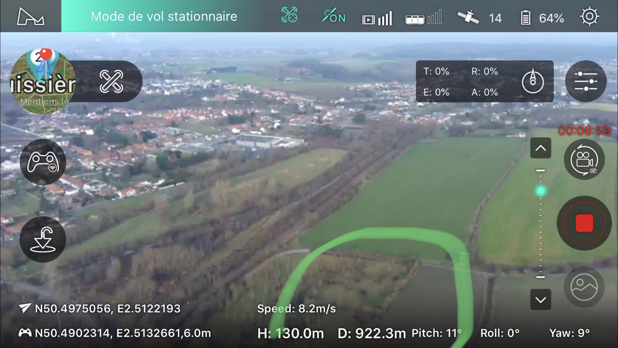

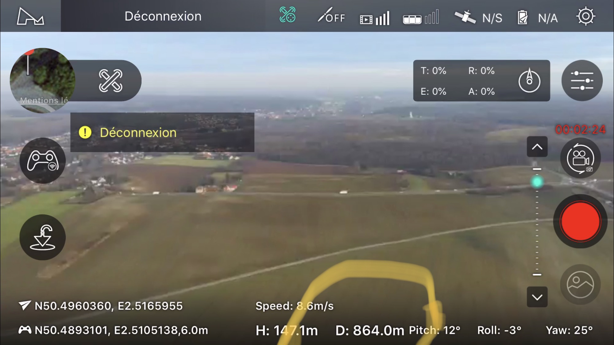

Personally, I have already made more than 10 flights to 980m distance before loss of signal, when at the height I am 150m to watch the French law. I climbed test at 300m over a distance of 880m also. No problem. I am on iphone 8 more for info. And whatever the phone, do not bind the ZINO WIFI phone, it is useless and it disturbs more.
