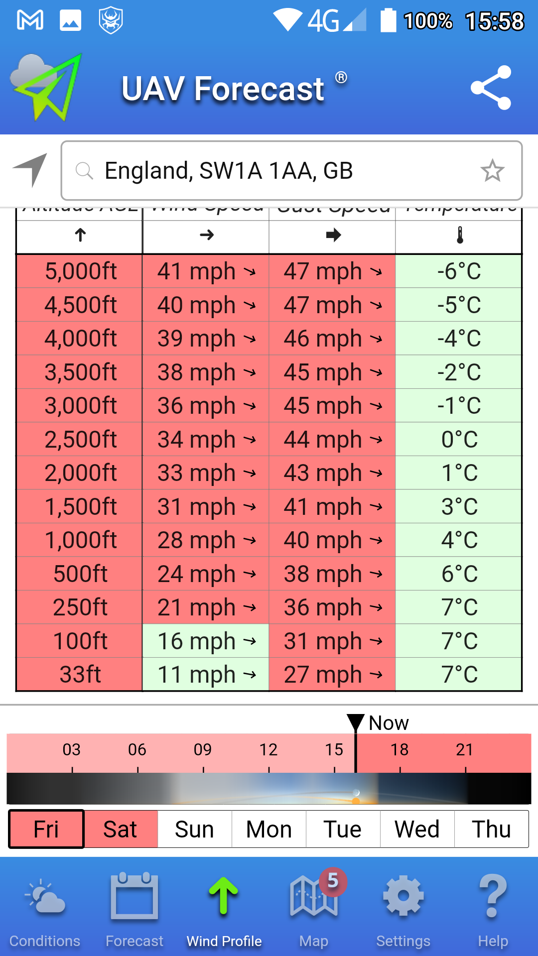

3) I know this is unlikely, but these drones are 249g and whilst pretty stable they are easily affected by wind which can feel like nothing on the ground but be way worse up high, especially in wide open spaces where you can see and the wind blows for miles unobstructed. I'd recommend using UAV forecast app on Google's Play Store (free) take a screen shot before flight, click on Wind Profile at the bottom and it opens up a list of wind at varying heights a screenshot again might be good precautions just in case of flyaway and as proof that conditions and wind levels were reasonable, as well as for your own peace of mind, its one less possible thing you rule out. You either let it use your phones GPS location or put in the postcode you intend to fly at before you go.
Main screen
Wind Profile

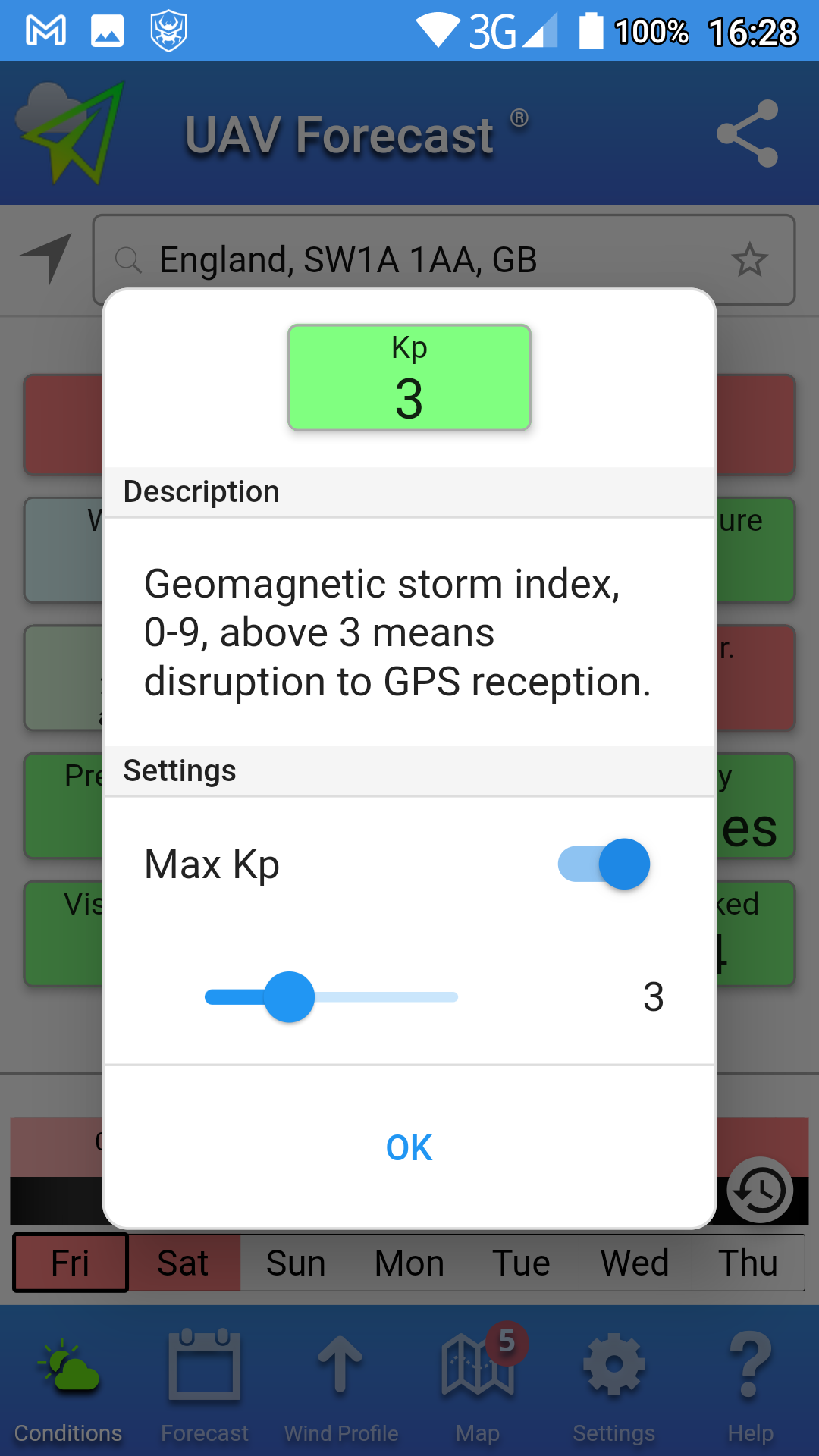

4) The UAV forecast App also includes a kp number which is the geomagnetic storm index, above 3 is where GPS signal may be disrupted so again is worth checking and having a screen shot of, I don't think many places will exceed a 3 tbh.
Geomagnetic storm index
