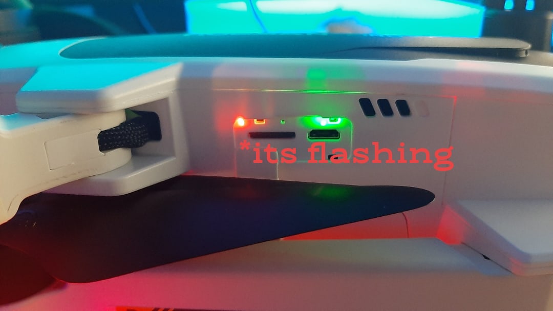

Hi, I just got Hubsan Zino 2+ and tried to launch it, but I got issue i have no feed from camera. First thought is my controller is not connected to the drone but is it not like that I'm getting some telemetry like heading, attitude and battery level. In the app I see that I have no video signal. And also I have red flashing light near sdcard slot. Hope for help.
Red LED

You have to check that the SD memory has the adequate writing speed (U3 class), you should also verify that your cell phone and the app detect the connection to the remote control if this is not the case you should try to manually pair the drone with the remote control

I tried to start it without sd, its make no difference and my phone detects the connection but only for controls I guess.

The problem must be the pairing or synchronization of the drone with the control, you have to try it manually from the menu displayed in the zino app, ultimately if it does not work, perhaps updating the drone via USB.
My last advice is to contact Hubsan technical service.
