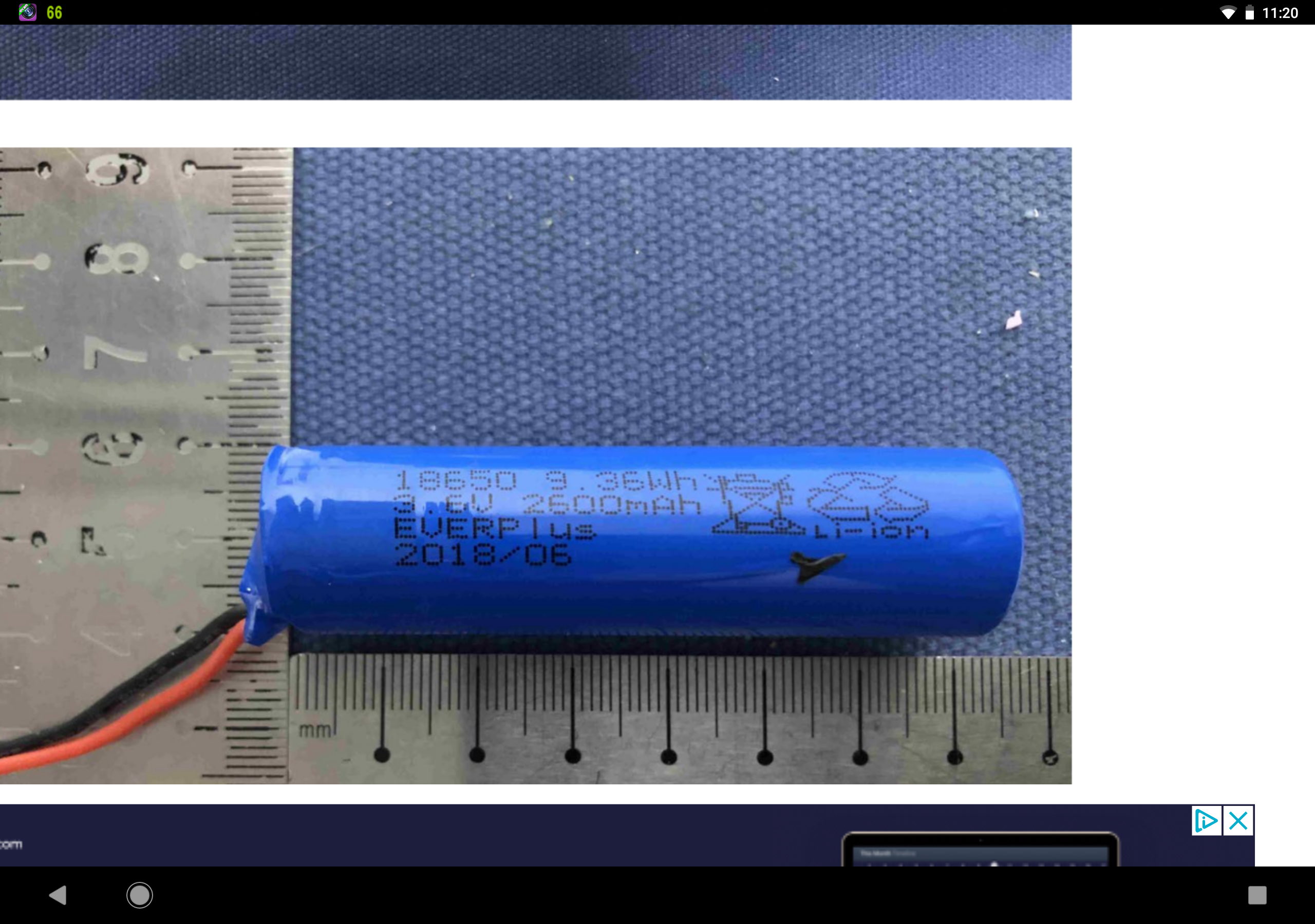

Post by Hubsan-Ailsa » Thu Jan 03, 2019 6:47 am
Hello,
The Zino transmitter battery :18650 Li-ion 2600mAh.

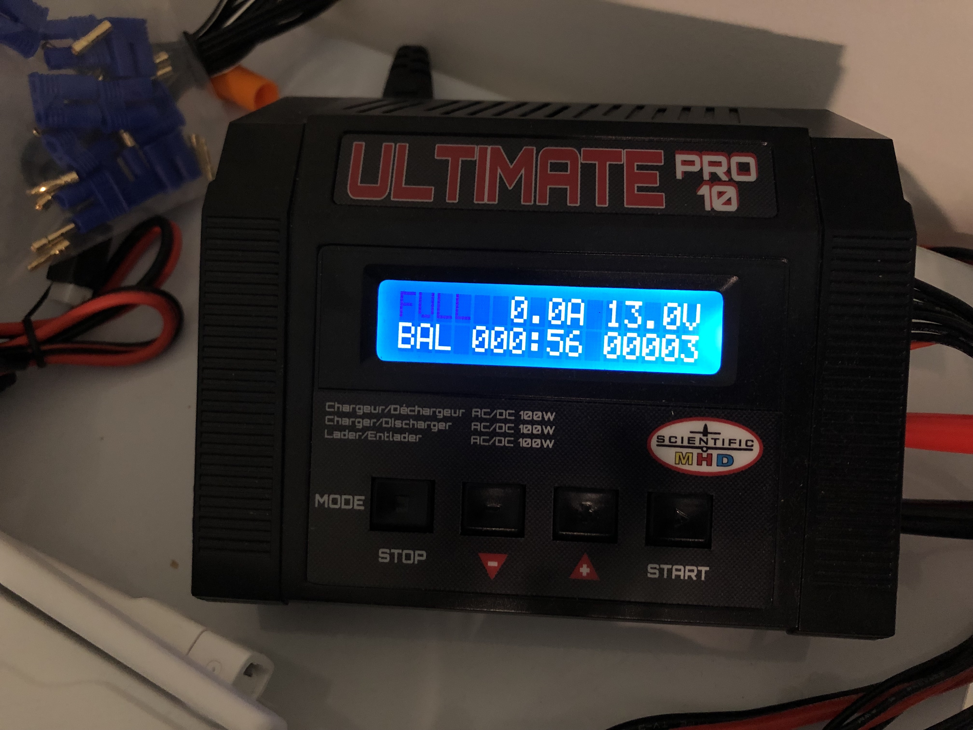

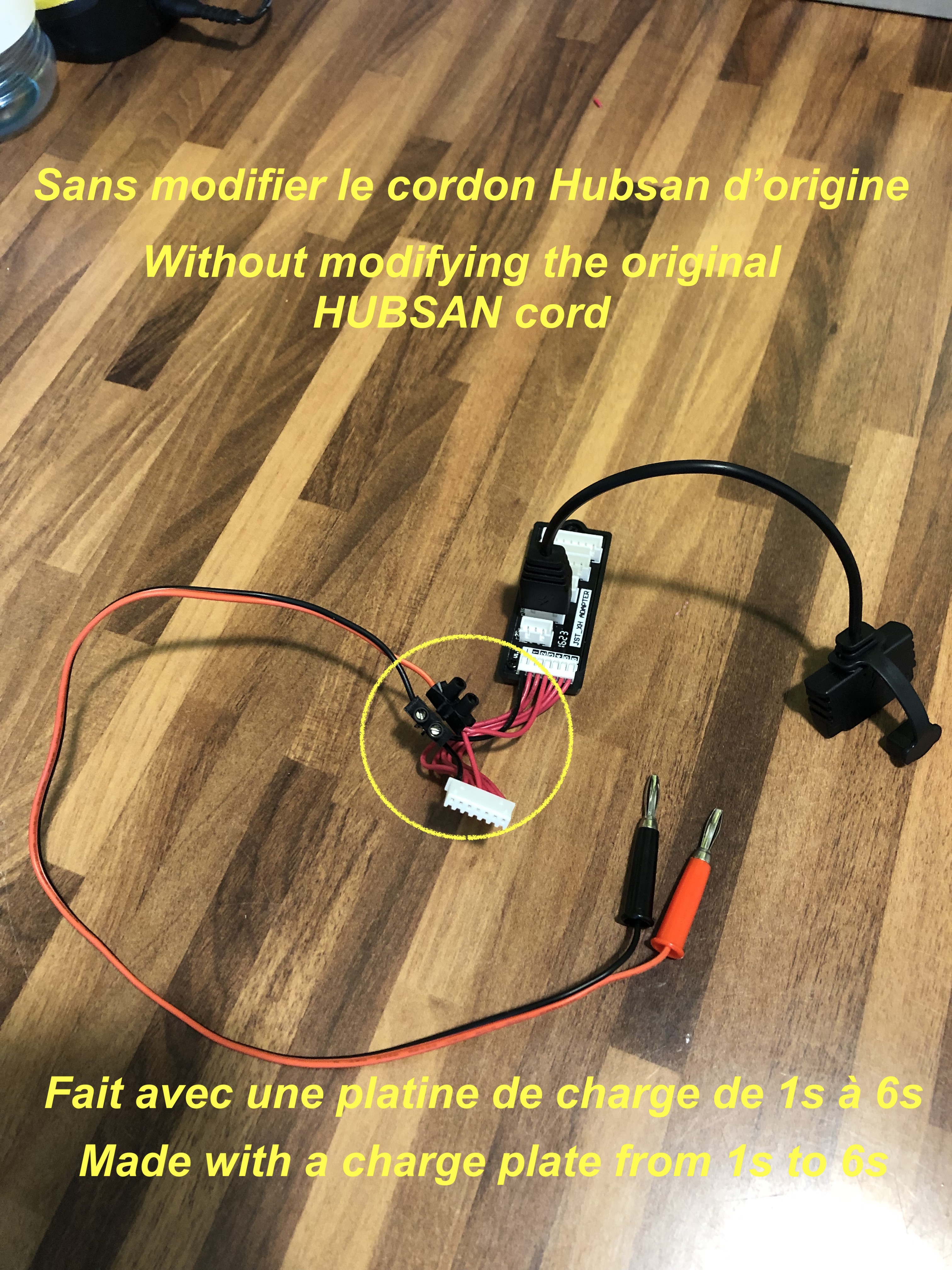

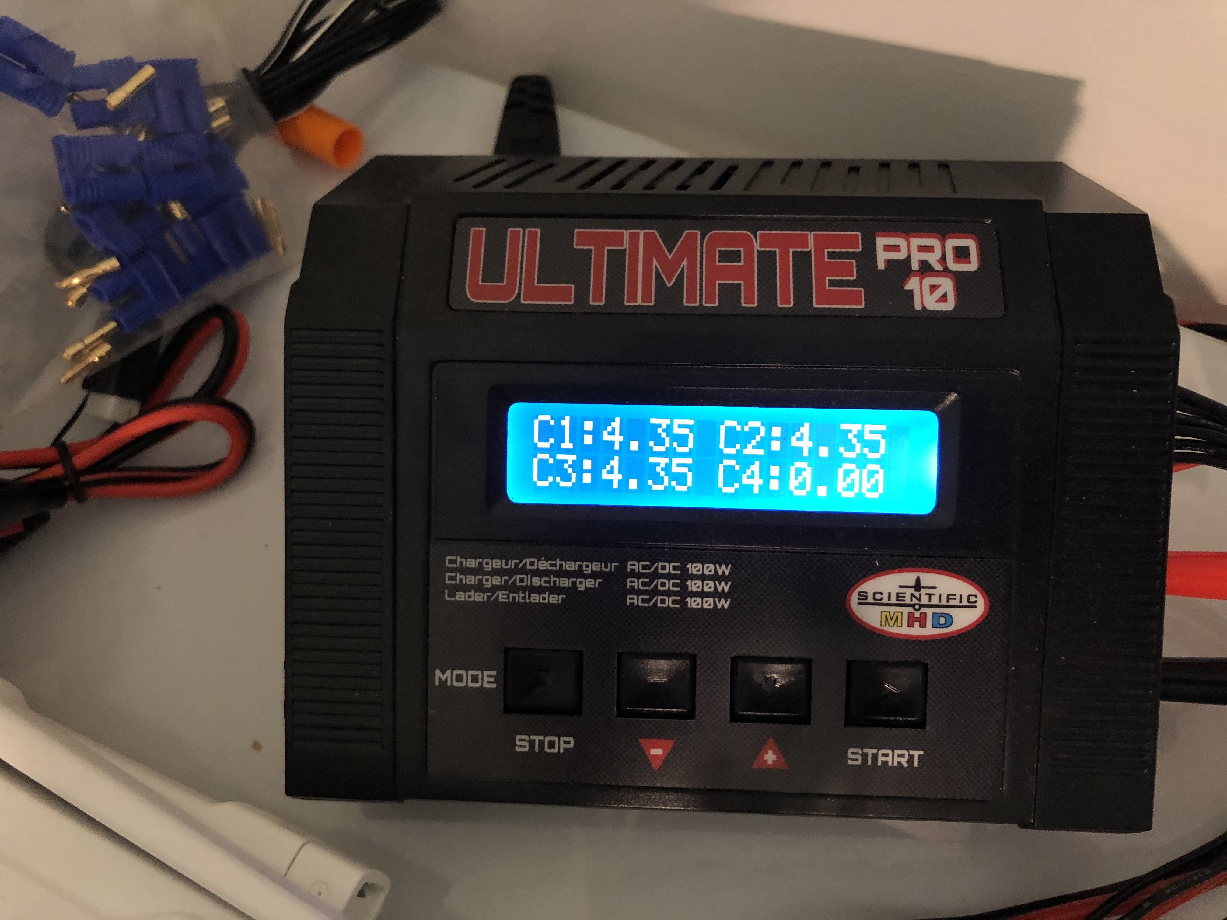

The batteries are LIVs at 4.35v / cell. The Hubsan charger charges at 4.30 / 4.32. I complete my load with a ULTIMATE PRO 10 charger up to 4.35 v with a perfect balance between the cells. I have made 92 flights to date, about 25 to 30 refills, the flight time at 20 ° is 23 minutes. At 4 ° it is between 17 and 19 minutes.

hola, yo tengo B6AC 80W , ¿en que posición lo pones para cargar esa batería? ¿en lipo? ¿hay que tocar algún parámetro para que llegue a los 4,35v? ¿si es así me lo parias indicar? las lipos normales solo admiten 4,20v como máximo , ¿ese voltaje de 4,35v es el correcto para esa batería ?
un saludo y gracias

Controller battery.

The Zino battery is a LiHV 3S 3000mah, max charge for each cell is 4.35V
The Imax B6 with firmware 1.13 will charge LiHV batteries as there is a setting for this battery type.

No need to modify your charge cable just get this already made ballance extension for 5.97 + shipping at Amazon.
