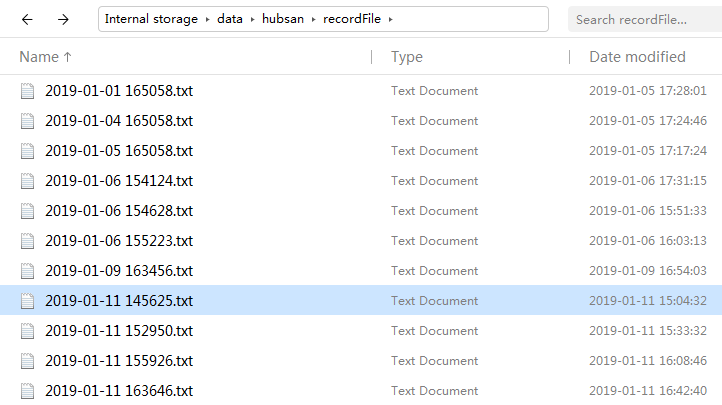

From my investigations, at startup, the device always writes "NO GPS Signal" to the logfile.
The log uses data labels (in chinese) to delimit the text file.

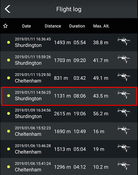

Here's a logfile from yesterday.
The Address = No GPS signal and the "Starting Point" Coordinates are
1.时间:2019/01/11 14:56:25
2.地址:No GPS signal
3.距离
起始点:51.868797,-2.08189
It shows No GPS in the app Log.
If I open the log in the viewer and scroll through the route, the log then populates the location as you have found, only of course if you have internet connection.
It then displays the location which matches a Google location search.
The interesting bit is that the raw logs are never appended themselves, only the log database (the bit that went AWOL during the last update).
Raw logs always appear to have No GPS as the default address.
One can only assume that there is either a bug in the app which fails to poll google for a location at start up, the request times out, or it purposely does not poll to reduce unwanted network traffic.
Obviously if you switch off network connections or use airplane mode (I don't) then you will never have a real time location anyway.
