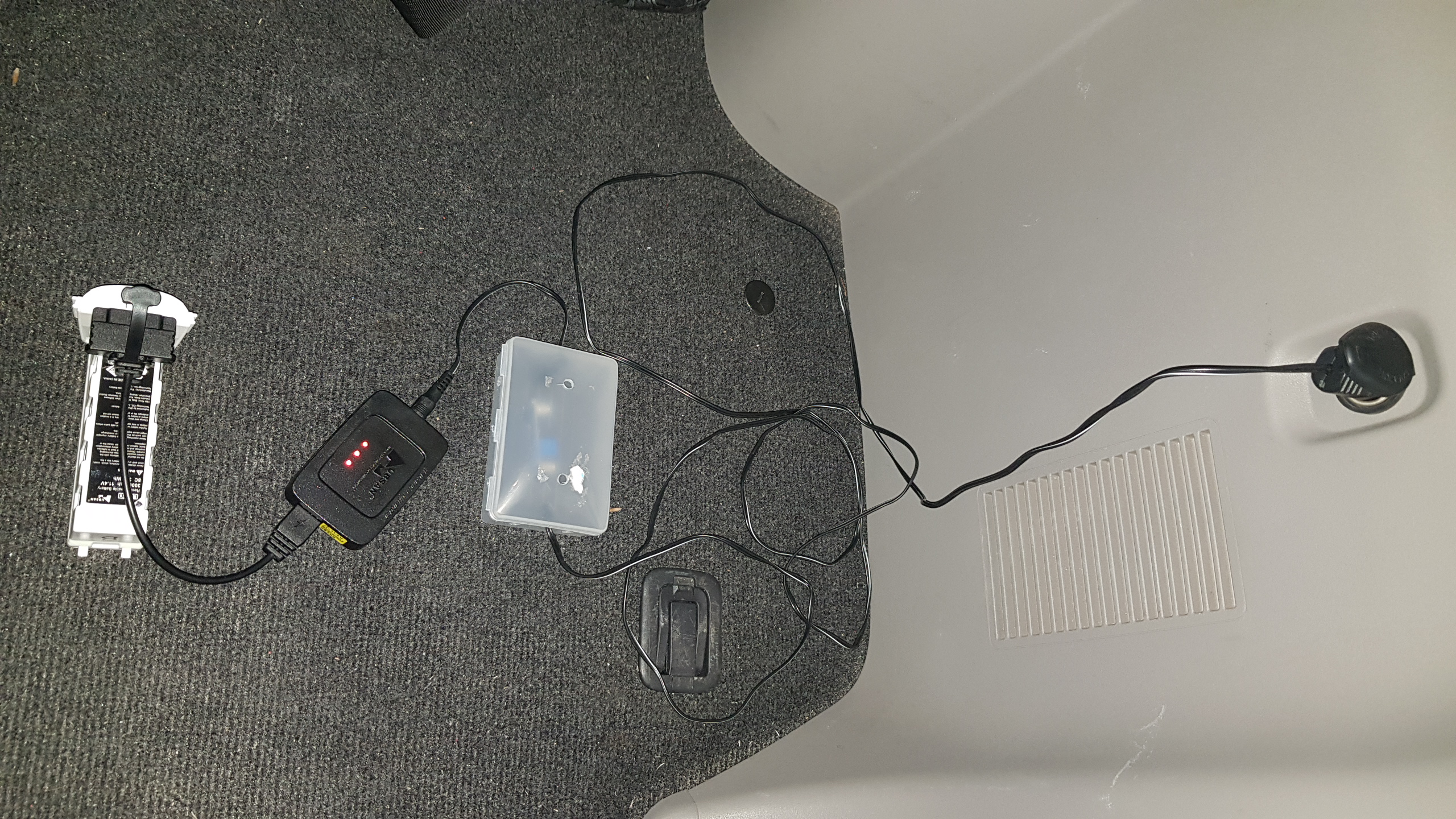

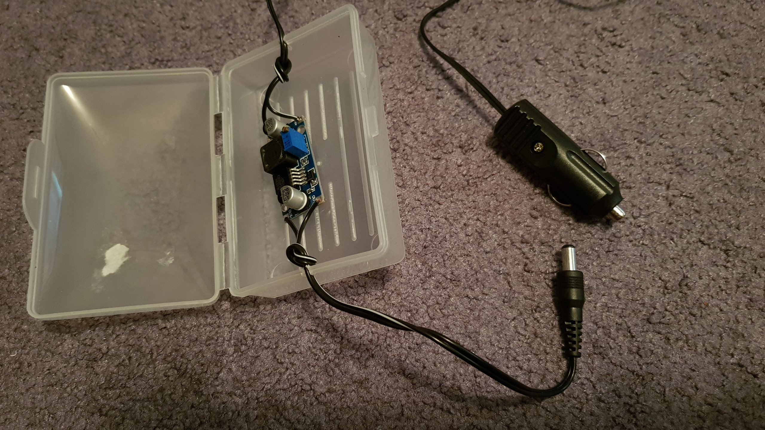

I have made a car charger that works. This will come in handy if you're camping or boating etc and you only have access to a cigarette plug. With the h501s, it's a straight 12v plug in to the charger but with the zino the charger wants 15v. So I purchased a voltage step up converter for $4 from ebay. This converts the 12v to whatever voltage you want up to 38v, in this case 15v. Had a flight, drained the battery to 28% and two hours later a fully charged battery. I have attached a picture to show the setup.
