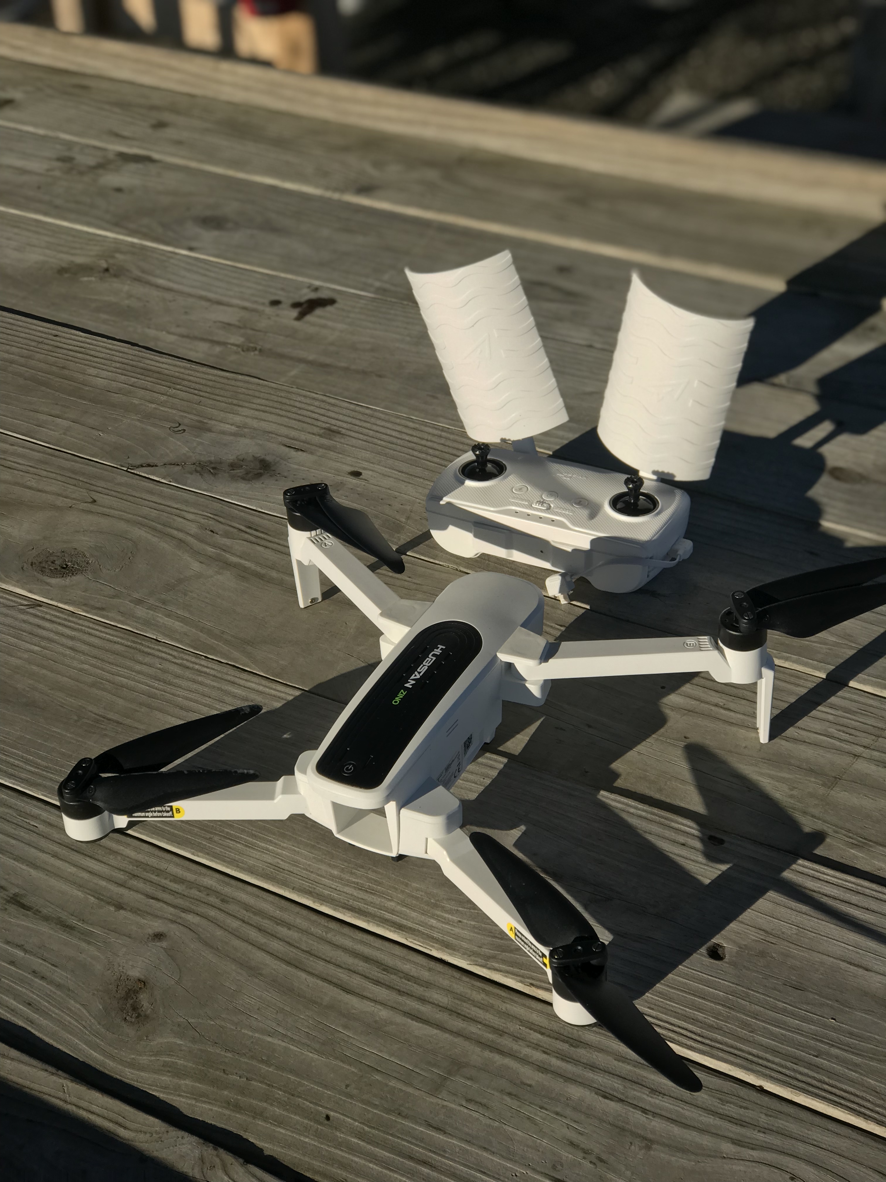

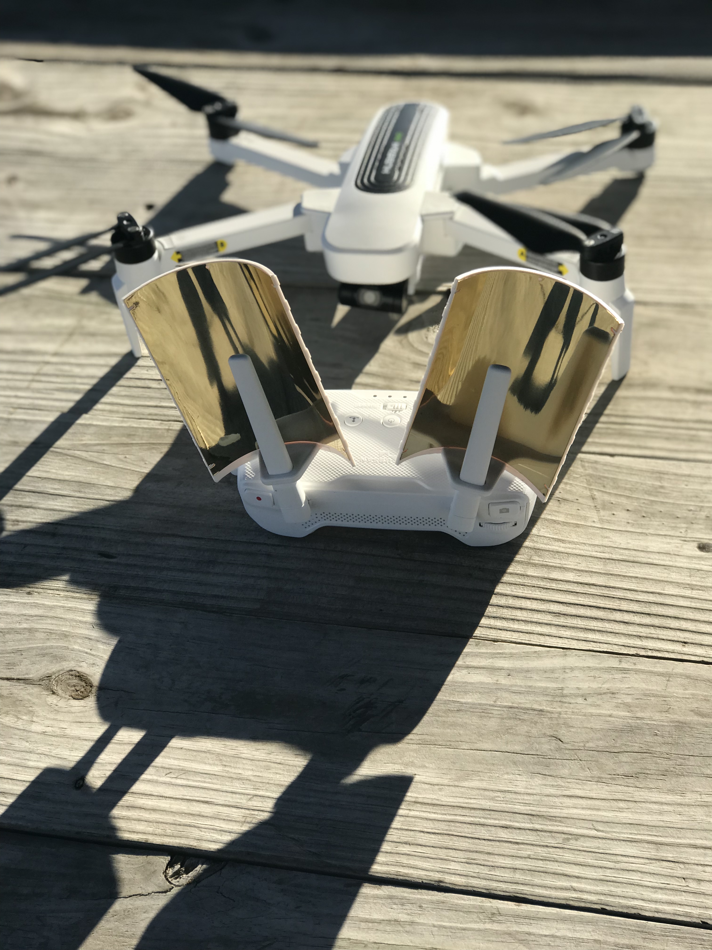

irussphone
Posts: 256
Location: TEXAS
Re: How to increase the range of Zino?
Post by irussphone » Mon Jan 07, 2019 8:00 pm
I have these but haven’t used them yet. Will report back when I do.
Djose24
Posts: 82
Post by Djose24 » Mon Jan 07, 2019 9:06 pm
Hi, I am interested in seeing the result of the test with those panels. I have noticed in my zino that from the 900 meters already begins to decay. It has enough autonomy to do more km but is limited to 1km. Good luck with the test and write the results soon.
