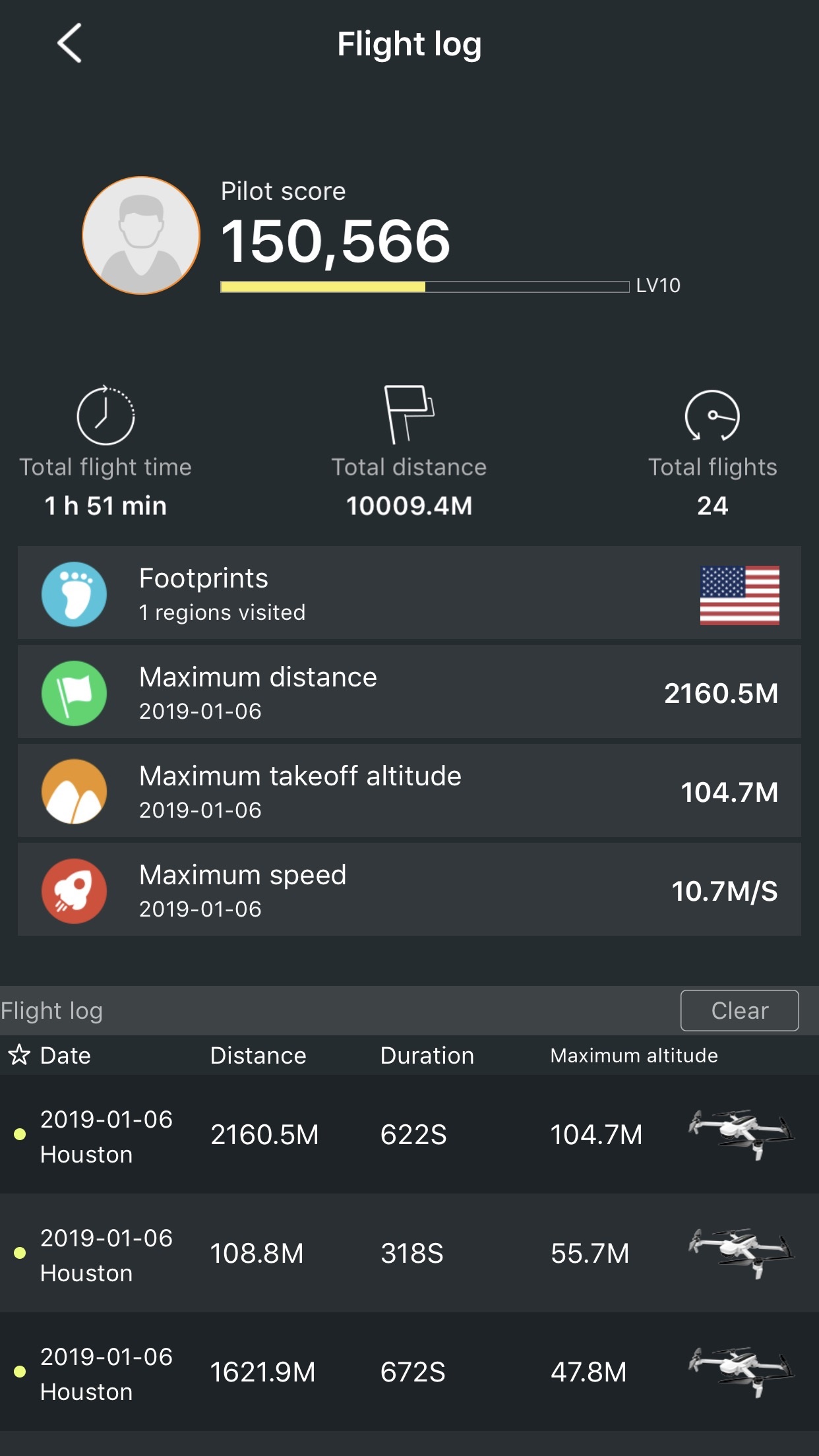

I have upgraded three times now and have followed directions precisely each time and this is the only time that there has been a problem (1.0.46). Yes I have the the "44" version and the "43" version on hand. How would you like me to send it to you? Hubsan should really keep a library of them available.
P.S. Here is my screen recording of my trouble connecting and keeping connected with everything that I did. I also did this a previous time that I did not record that was the same exact outcome on the same day (this last Saturday).
Russ
Flight Log.jpg (271.92 KiB) Viewed 13291 times
