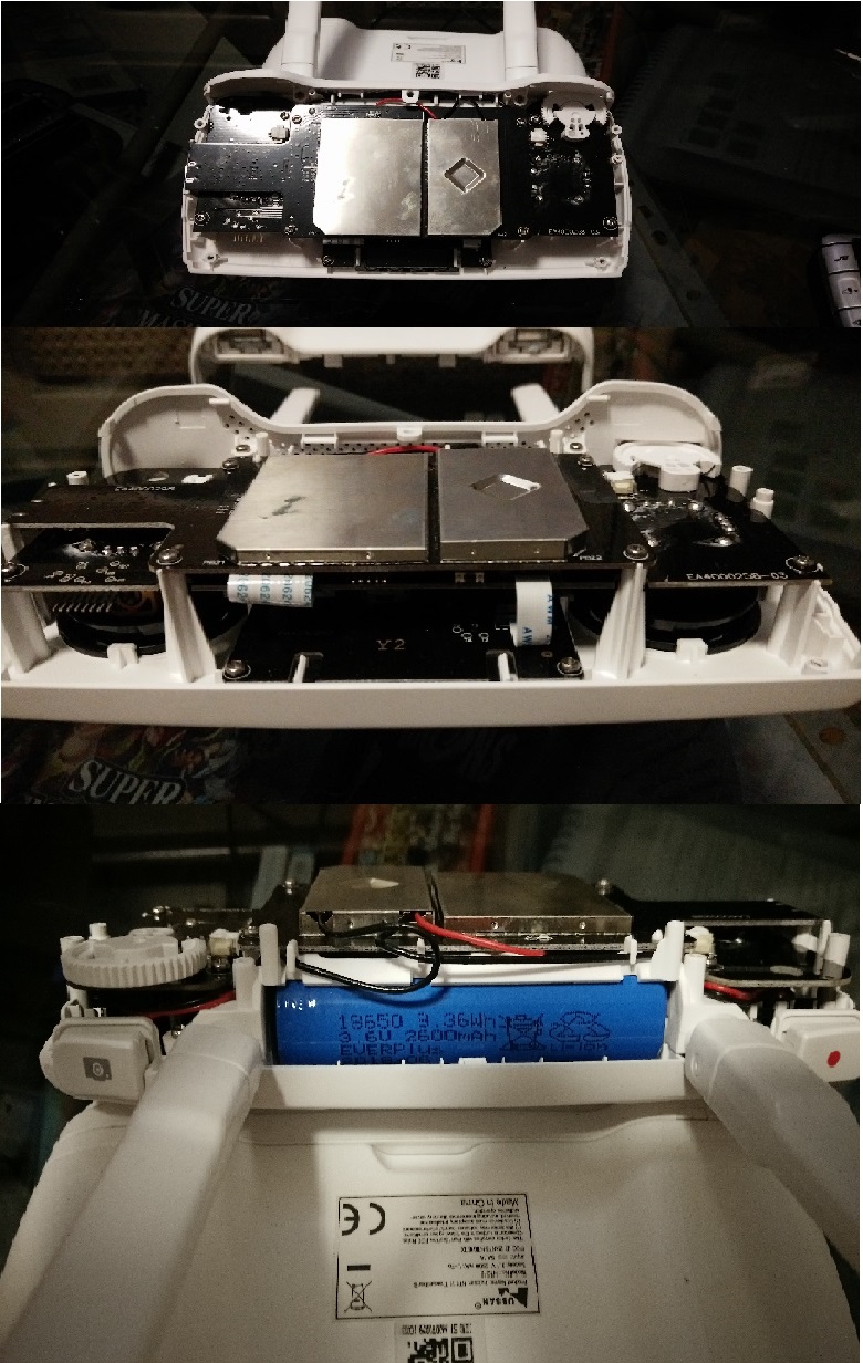

The Zino's controller is powered by a 18650 Li-ion battery, rated 3.6 V, 2600 mAh.

If it needs replacing before the drone is history (it should last 2-3 years) it is just a 18650 Li-ion battery as fb_43b9ftbKWM said. It takes six odd screws to get to it. Take back cover off 4 screws, take antenna cover off, 2 screws. You might also need to remove the antennas to gain full access. Hopefully it is not soldered in place :o
