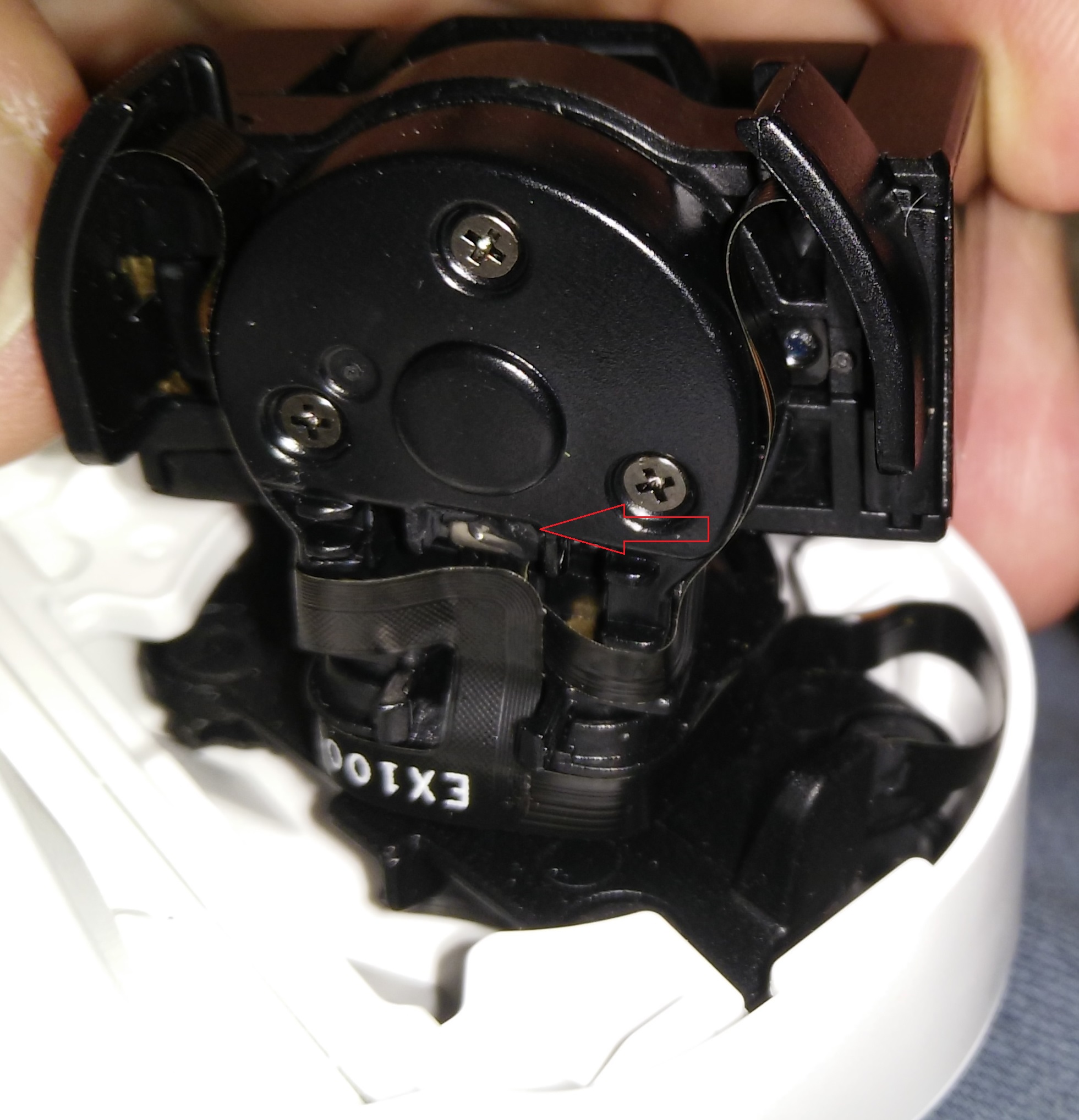

For those having trouble finding the gimbal reset button
peterkng
Posts: 104
Post by peterkng » Fri Dec 28, 2018 7:46 pm
After removing the cover plate you should see this. Arrow is pointing at rubber covered button. Fine needle nose pliers are probably the best tool to use to press the button with.
