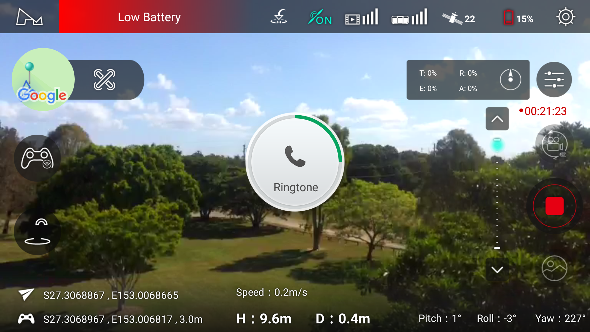

Hover test in 14-18kn (26-33 kph) winds recording the whole time at 1080p 60fps. Took off and flew out about 5 metres to a height of about 5 metres.
At 15% battery at about 21:20 the Zino execute an automatic RTH and landed, screen cap of phone was taken just after RTH initiated.
Whole flight was sticks off and just under 22 minute from take off to landing still with 15% battery remaining, I did not attempt to override the RTH.
