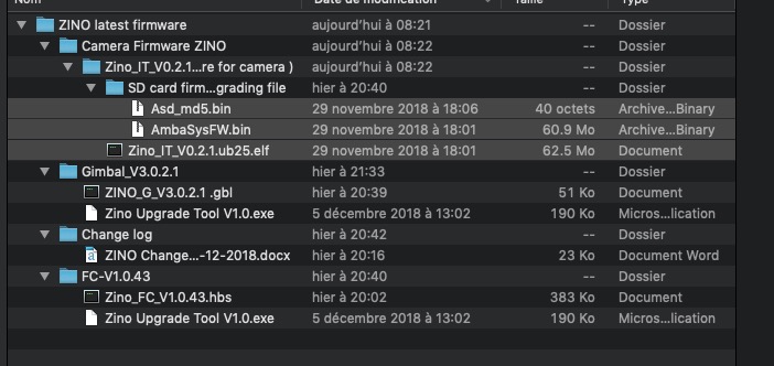

Hello, I managed to update the firmware of ZINO on my I-MAC, through the installation of VMWARE FUSION virtual machine in test mode 30 days free.
A bit of trouble to connect the ZINO USB on this VM, but by clicking a few USB connection parameters, I saw it appear and I started the update, as indicated in the video, step by step step.
(Very Important: at the end, when you copy the files for the camera, in the video we see 2 files, but there is a third one which must also be copied on the MicroSD, then erase the 3 after the update. day)

Hi Magnum,Magnum1956PMQ wrote: ↑Tue Dec 11, 2018 5:33 amWARNING:
The update files have been changed since yesterday!
Repeat the download on the HUBSAN website.
I compared the first download and the actual now. I see no difference.
Who told you to use the third file (Zino_IT_V0.2.1.ub25.elf) , which is not into the Folder "SD card firmware upgrading file" ?
I think, it is not needed at the sd card for update?!

I was able to update the firmware on my Zino using the tutorial video. It took a few tries and move gimbal file manually to the gimble tool folder, but it worked. I used my old Laptop with Win 7 (don't laugh
) I've got two other PC's for gaming, with Win 10.
In this order
Flight control FC (Zino_FC_V1.0.43.hbs)
gimble fw (ZINO_G_V3.0.2.1.bbl)
camera/SD card firmware FW (Zino_IT_V0.2.1.ub25.elf)
When you open camera firmware it also calls it SD card firmware. In that folder you have to copy the 2 files to a SD card my first SD card did not work it was SP micro SD XC Elite 64 G
my second card worked it was a Samsung 32 G Evo select HC
The new updated firmware did a speed check on the memory card. PASSED
I hope this info. helps
