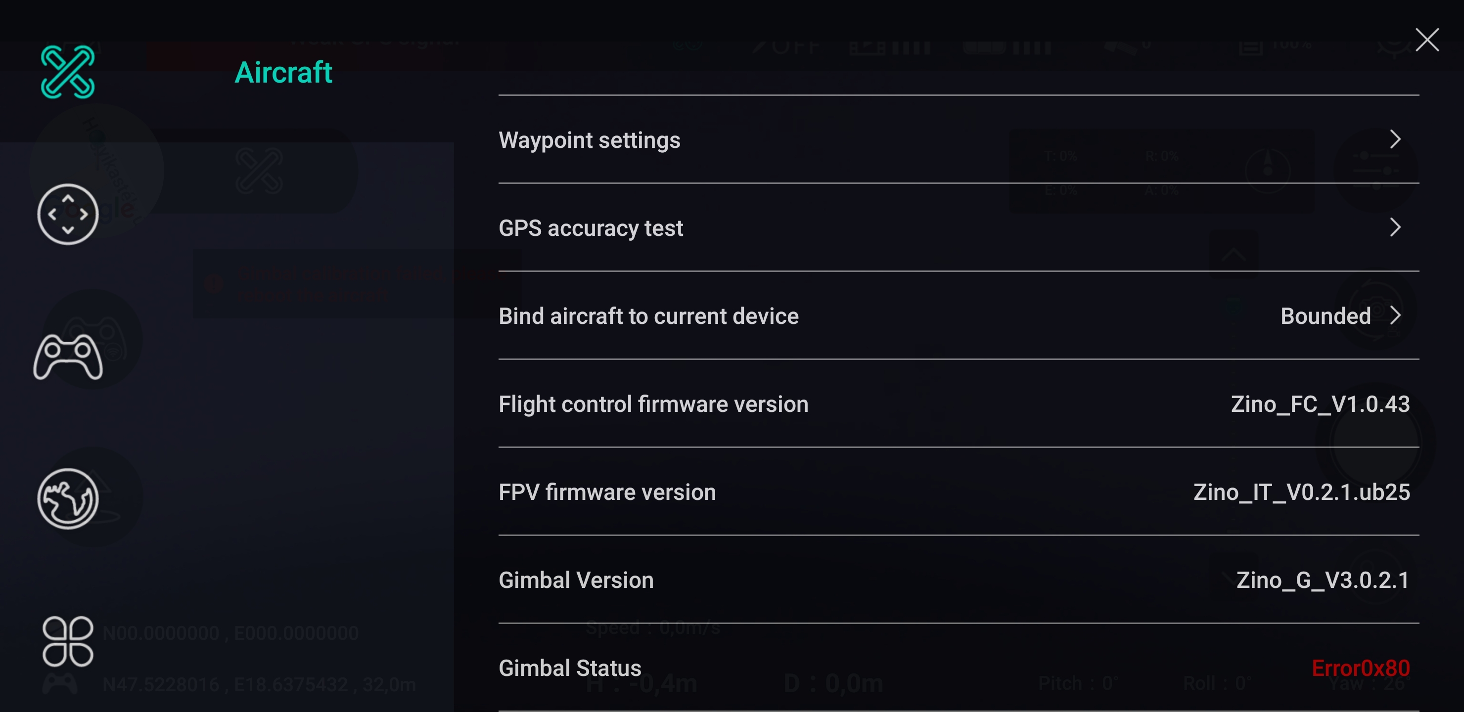

I bought a Zino. I refreshed the software.
Gimbal status is ERROR0X80
The Gimbal is in down position and move a bit.
I restart the Zino repeatedly but happens nothing.
What can I do?

Hello Karakastibor ,
We want to confirm if your gimbal status error is 0x80 or 0x0800?
Would you mind to take picture of the Error code for us ?

Hello Ailsa
Error code 0X80
Thank you for your answer
